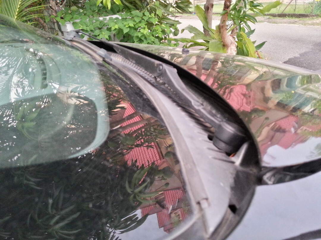

Thanks bro. I have done mine as well. I can feel the heat coming out from the engine bay everytime the car stop.
