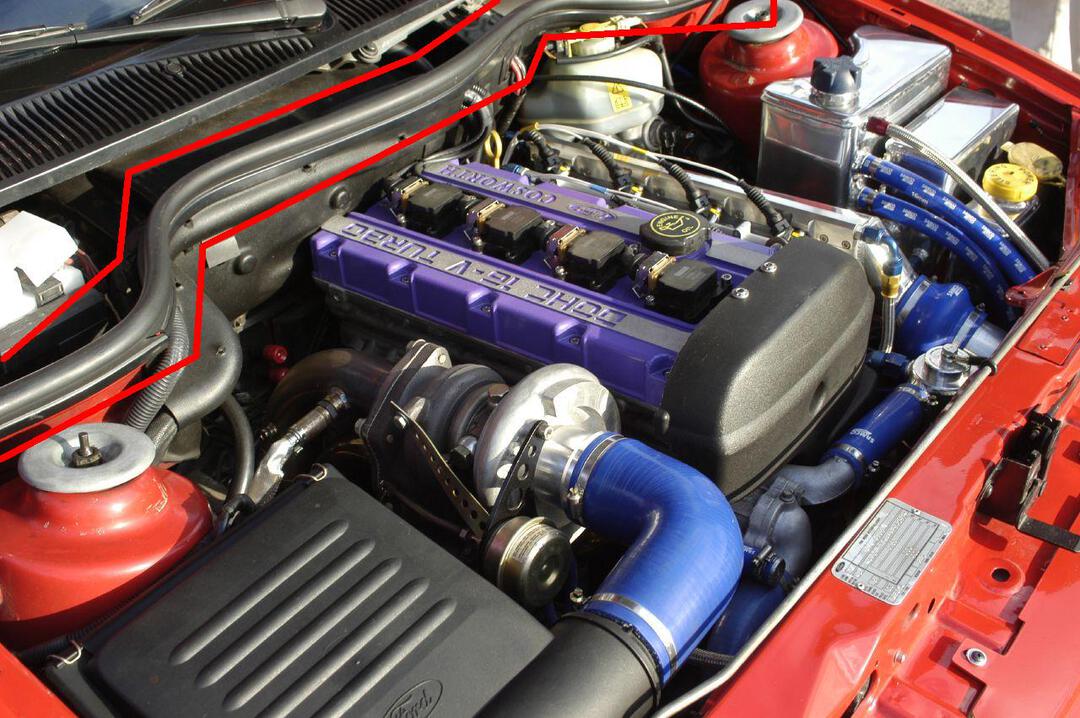

3- Remove the wiper cover rubber as in the redline in the picture. It will make better air ventilation.

by removing the wiper cover rubber, wont water or rain seep into the engine bay?
The rubber is higher up, water will drain into wiper motor area. Maybe some water will still splash into engine bay, but more actually comes in from the front and from underneath and most splash up by the belting....

I also removed mine.. as raised hoods sometimes poses a danger whereby if the mechanic or other ppl is not careful when they are raising your hood, it might break your windscreen.. or sometimes you yourself when you are in emergency cases and you forgot... the tip of the hood will hit the windscreen then = hailat.com :biggrin:
