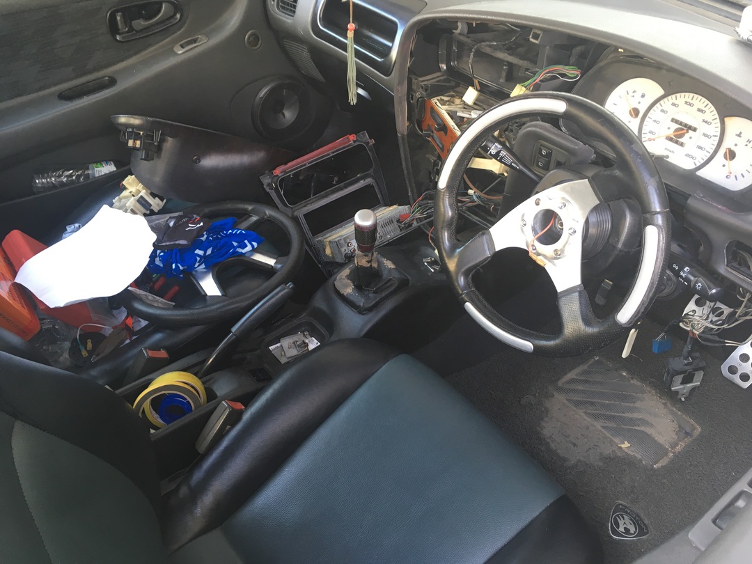

Looks very probable bro, tonight i go check it out, that day i took picture macam nothing there, but there are a few loose connectors here And there too. So tonight i Go Check if anything there. The wiring below is a nightmare.
Some are left blank which are for some gadgets not present for local model. My Mitsu engine bay main fuse box have a few empty slots too......
Takde relay , I don’t know which is the connector too, now I’m at accessory shop, since my meter Ada menyala ada yang tidak. So later ask them is which connector haha. Later I update you all for education purposes.

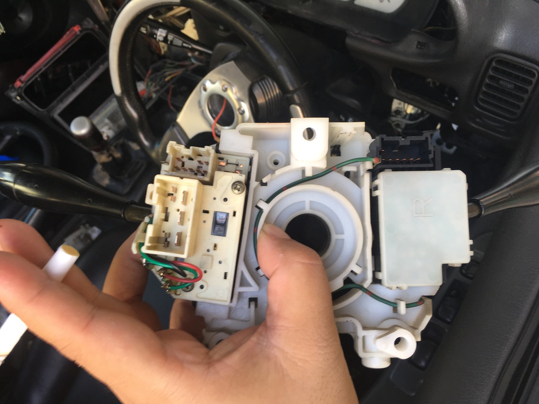

I’ve swapped out the whole console liao with new one . Still one speed , so don’t think this is there.
On a separate matter. The previous owner installed some sort of wire into the meter , still don’t know what, could be a rpm wire to an external meter cause I see 2 holes on top of the dash.

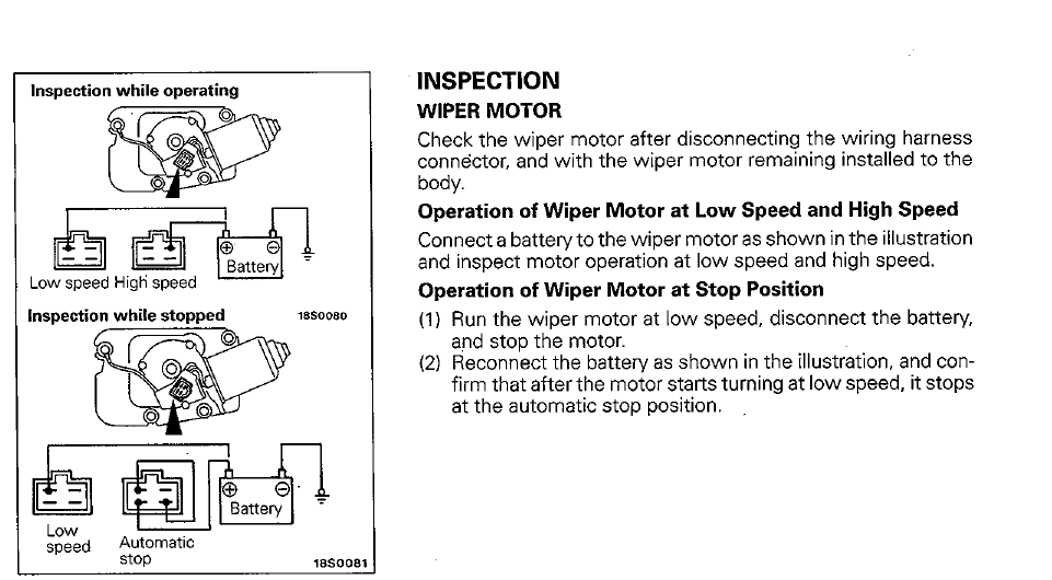

So a visit to the acc shop, the owner came to a conclusion it is weak motor and faulty wiper linkage. Therefore I’m not going to fix that first , not so essential.
