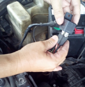

I own an old Proton Iswara manual 1.5. At times, I have problem starting the engine. It gives a tick sound but it doesn't work. I need to turn the key a few times to get it running. My car has already installed with a starter relay long time ago. In fact, I have just replaced a new relay. But the problem still persists.

One way to check is when next time it wont start, check to see if relay got triggered
If you knock the starter and it can start then probably the starter problem already. Usually switch problem adding relay can help unless the switch really gone.....
I know where the replay as I have just replaced a brand new one. I will give it a try as suggested. It is the starter which I am not too sure where is it located.

Hey, now it is working perfectly. Just a turn of the key and starts right away. The brand new relay is the solution. :burnout:Thank you guys for your tips and time.
