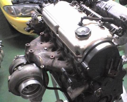

Just finish Build Proton Perdana 4G63T SOHC.The engine running with Microtech LT10s with Holset Turbo.With Low boost 1.3bar we get 350whp 98 shell V power fuel.
SPEC Machine
1.Head Port, Polish and Chemical Cleaning
2.Valve Job
3.RPW Stage 3 Cam
4.New Valve Seal
5.MSD Twin Coil
6.MSD Cable Plug Custom
7.Pistons Wiseco 85.5mm 8.5:1 CR
8.SCAT 4340 Rods
9.ACL Race Bearing Rod/Engine
10.Block Deck Surface
11.Cometic Head Gasket
12.OEM Header with Flange T4
13.Xtreme Clucth Set
14.BPR9ES Spark Plug
15.AWD Evo GearBox
16.Aerospeed Adjustble Cam Pulley
17.Microtech LT10s with 3Bar map
18.1000cc X 4pc Injectors
19.Bosch 044 Fuel Pump
