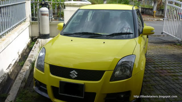

This is a brand new Suzuki Swift sport, fully import from Japan, which delivered to my friend. Good looking little ride. But later we discover a can of hidden worms – paint defect on a new ride, paint transfers…..more & more
Professional car detailer in Malaysia in training
I got to know him, through one of my public detailing session & he contacted me to him detail her.
Upon meeting up & viewing the car at night, without much street light....only with my little torch light, i discover patches of paint ..on the front engine hood. almost covered 1/3 of the right hood, only found out after his 1st wash & without realizing during the delivery time, he already complaint to the car sales man (of this defects) & he actually drove this to Megs detailing centre (they even did some wet sanding to demo to the owner) but not complete restore

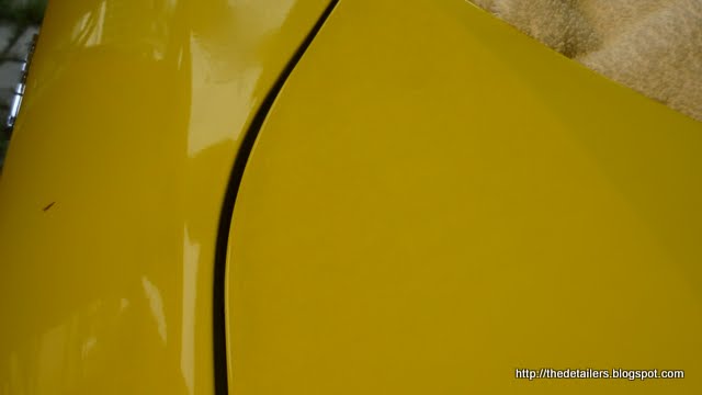

obvious paint defects with some underlining issue
patches of stains only on the repainted area
side wallls
rear bonnet stains...on this bright bumper bee
after wash, defects seems to be clearer
Before wash – look carefully on the scratches, lines & stains
Agitate with Optimum power clean 50/50 % comparison area , as u can see the upper hood is sprayed and showing cleaner than the bottom hood

Pain defect – over sprayed & wet sanded before pics

now the real issue........... over sprayed vs resprayed???? pics...
see t the imperfection of the paint
from a new CBU car??????
let me asked you would you pay for this???? agreed to go home with this condition from the delivery??
pics before corrections
pics after corrections
more at the centre hood...resprayed defects
