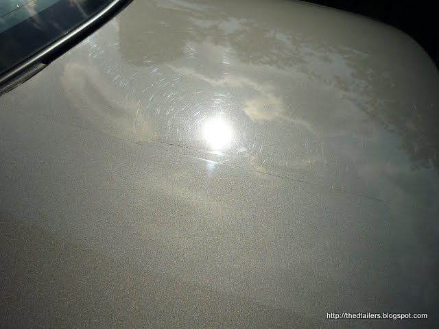

just got it on CNY - 2 yaers old car - lady driver - fequently wash by road side car wash & resulting....swirls & deep scratches
this is one of the rarest moments - finding swirls under bright sun light

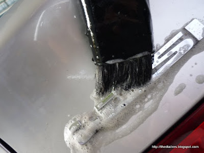

2 bucket wash with APC 2oz mixture - micro fibers

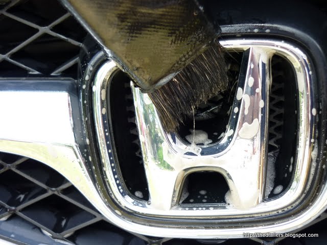

Osren Multi purpose cleaner with assorted brushes to cleans emblem & hard stained area

Paint correction - Rotary with Lake country Yellow colour cutting foam for removing swirls & Random Deep isolated scratches (RIDs) with Meguiars M 80 Mirror glaze polish ....speed 600 to spread, 1000 with gradual movement & speed , finishing off at 1400 with moderate movement
paint polishing - rotary & Lake country polishing foam pad at speed 600 to spread the products & Speed 1000 move moderately with pressure & backing off to speed 600 with light feathering off

Osren MPC at work
mkore MPC at work agitating
front bonnet plastic fender
front emblem cleaning

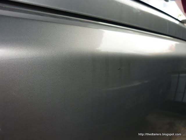

now after a clean wash...closer inspection on lower paint contaiminations
lots of stains - hardly can be removed by mere washing & scrubing

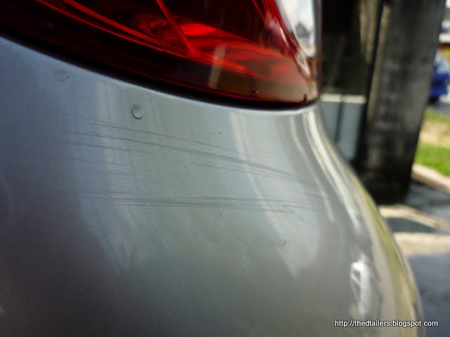

more before - rear left bumper
after
only after one pass

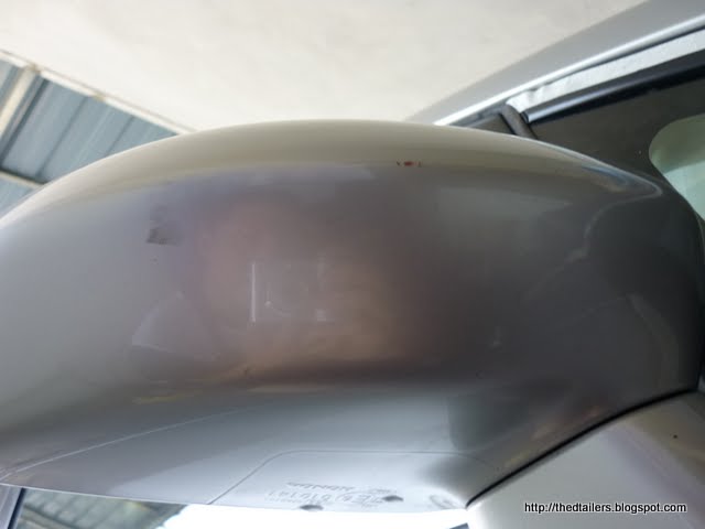

side mirror before
after detail
