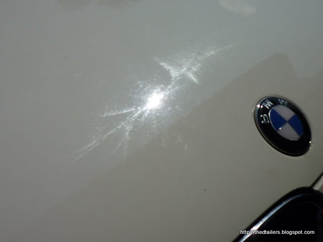

abrasion holograms, often reffered to as buffer trails or machine marring, which are microscopic scratches in the paint caused by micro marring
different strokes
Another cause of paint defects are known as Buffer Trails . This is caused by the misuse of a polisher either rotary or orbital polisher, They occur when the polish pad has not been clean regularly, or over work product

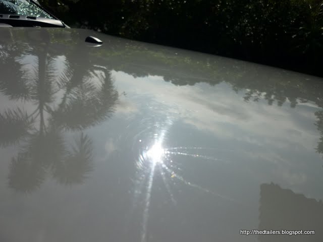

Direct sunlight can make a car with buffer trails and holograms look exceptionally awful

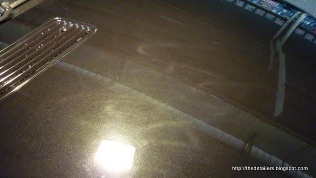

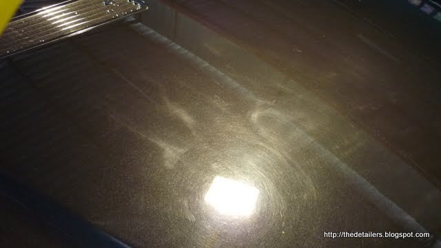

so be attentive what they use to detail your car. is it a dirty foam pad or a worn out wool cover with jeans cloth??? do they have halogen light..or just using normal florescence lamp
