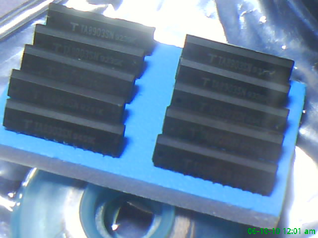

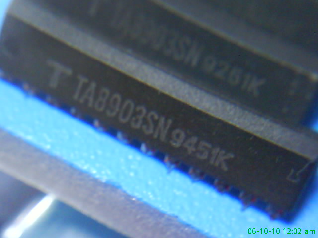

Ogip... try change this IC....
Looking at my stock, you should understand.... tq
