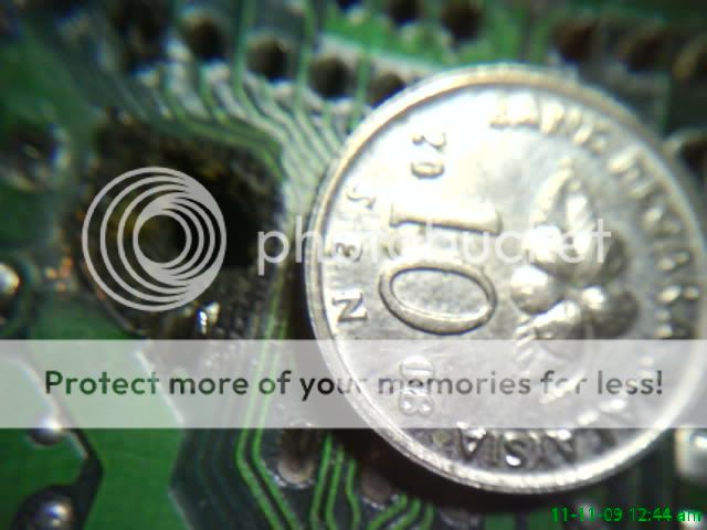

Guys...
this picture is the ecu that smoked after a customer balik kampung..was a P27
When reach his destination he smelled like something burning..
Finally he traced it to the ecu...
10 cents coin is for your reference of the hole size....TQ

I agree wit Etech , i experience this problem before(last year). My ECU smoke when i reach my home and i smell a very bad smell. I cant even start my car. After do checking , i noticed that my ECU already black in colour just like shown in the picture. So........ got no choice , have to buy another Ecu........ Guys better becarefullllllll.
