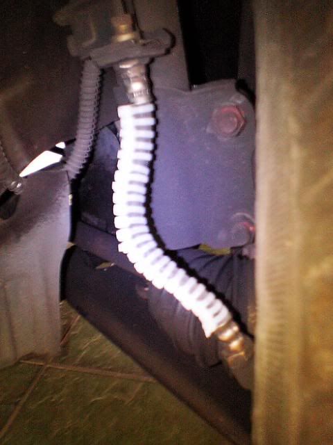

DIY "braided" rear brake hoses - Update :
Today me finally managed to buy enough black cable ties to DIY braiding of my OJ's rear brake hoses!!
Had to use a hydraulic jack to raise the car rear & support with axle stands b4 can reach the hoses.
Took me abt 2hrs to complete this DIY session...from under the car!! :rolleyes:
Here is a pic of the completed "braided" LHS rear brake hose :
http://img98.imageshack.us/img98/9594/braidedrearbhkx7.th.jpg Pl click on image to enlarge.

I can't speak for others, but, frankly, from my own DIY efforts & results, ZTH's own style DIY braiding works!!!

Nice work there, Tykoh!! A well-made caterpillar lo...nice pic too!! hehe...;)
Yup, effect experienced only on SUDDEN braking.
Try driving just a short distance and jam on yr brakes!
If yu'd tried doing so b4 braided DIY, yu'd notice the diff liao! A more solid feel...noticeably faster stopping, too! :)
