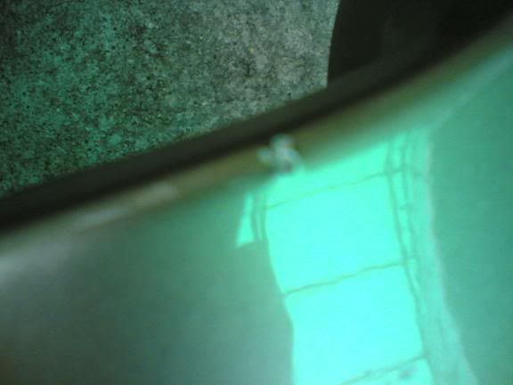

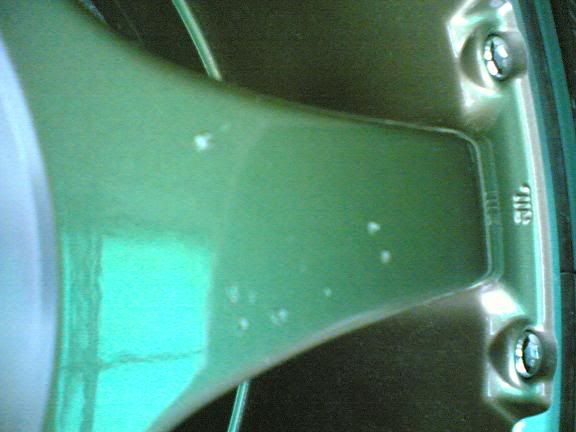

i unscrewed all the screws on my rims ady, then jacked up the car abit more, but still couldn't take the rims out ... so i continued jacking up the car la higher abit ... tiba tiba the rims at the corner of my eyes plopped out from the screws n landed on the ground FACE DOWN ... sigh. i cant climb under the car im not having short hair lol ...
anyway this is the pic of the scratch on my rims, the dot kinda scratch... sigh.
anybody can advise anyplace that i can repair scratches on my rims ? very sorry for going outta topic
uish... sakit hati ohh see brand new rims scratched like that....
i not sure where can repair scratched rims ler.... but if small small matter nvm lo...try use polish and polish back the surface... might work... hehe...
