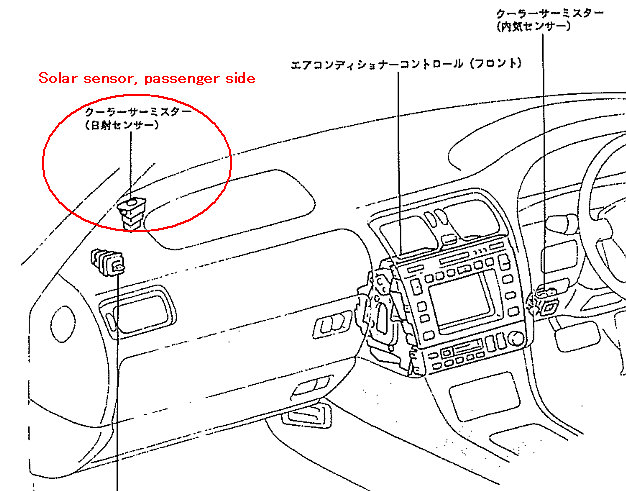

i already send the car for diagnostic this morning. only 1 error code found. it's "a/c solar sensor passenger side". so funny, doesnt happen b4 the timing belt replacement. is this sensor related when replacing timing belt? haha...beside that the mechanic also check the timing. all ngam & cun, no missing tooth, all lining mark ngam..all wires & sensors on engine side checked...but i still feel relief because there are no fault code from engine side..all seems healthy...tried to reset the error code but cannot reset..but the a/c still working fine, still cold..i guess i have to live with this CEL on sometimes..or maybe there hay wire to this sensor..
Ok I did some digging and it looks like you might just have a loose cable somehow. Perhaps what you can try to do is take out the sensor and see if it's plugged correctly or just clean the contacts with contact cleaner and see if that solves your problem.
yes...correct...altezza have auto mode...so the solar sensor will detect temperature from outside the car & compare it to the temp imside the car. so it will regulate temp inside the in auto mode
Check the wiring for your sensor then. Might be loose or something simple
