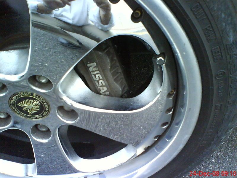

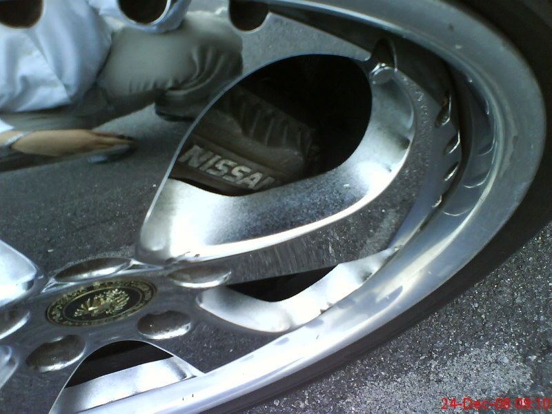

I'm done with original A33 Rotor and Pads.
The Original rotor can't last 1 year and started to warp and crack!
2 Weeks ago, my 2nd set of original rotor is showing signs of warping and break pads also about gone...i decided to swap out the whole brakes (rotor + caliper) and fit in a R32 rotor + 4Pot caliper instead.
Original Rotor RM700/pair + Ferodo pads RM260.
R32 Rotor+Caliper+workmanship RM1350.
Re: Wrapped Front Disc Rotors
dream.tent,
wow the conversion cost RM 1,350 i hope it the spacer that cost that much.
If you have the correct rims, the r32 caliper + disc only rm 300 - 400 only.
The modding on the mounting is about 280. The pad is about 270.
All in lap lap chap chap 1350.
Anyone else has reference for pricing and workmanship for brake conversion?
Maybe my price is on the high side.
But since i don't have to deal with the original brakes, i'm ok.
(Last full original set also cost me 1.2k d)

if got correct rims, no need much mod only need to skim out a bit off the r32 brake.
Anyway, i am thinking to change it to murano / z33 single pot brake. that one its much bigger and better :) now waiting for my friend to find me one when he is back to japan.
