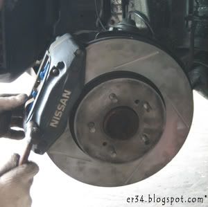

On my R34 GTT, the discs were warped as I can feel intense vibration everytime I brake hard. After which I got the disc skimmed and slotted as below.
After a couple of weeks, the sympton re-appeared. it's not as bad as the first time but the steering vibrates whenever I brake hard. It's annoying me to the max and my mechanic says it's a common problem with Skylines. Is that so?

After skimming it was perfectly ok. Just appeared a few weeks later after that so I'll rule out uneven skim. Pads are new Endless units, changed together with the skimmed discs.

The disc should be well skimmed as it was OK for the 1st couple of weeks, if not it would have shown the moment I drive out from the shop. Worn out calipers? Which component specifically? I checked the piston rubbers and they are ok.
