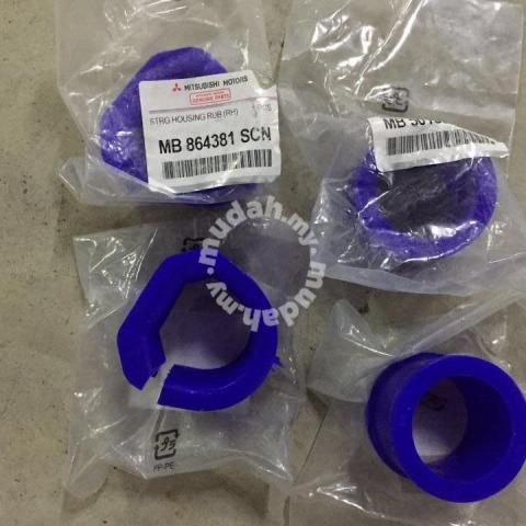

Ok, can try... this is the bush right? Meaning if the bush is spoiled/cracked, the whole steering rack will move slightly right?

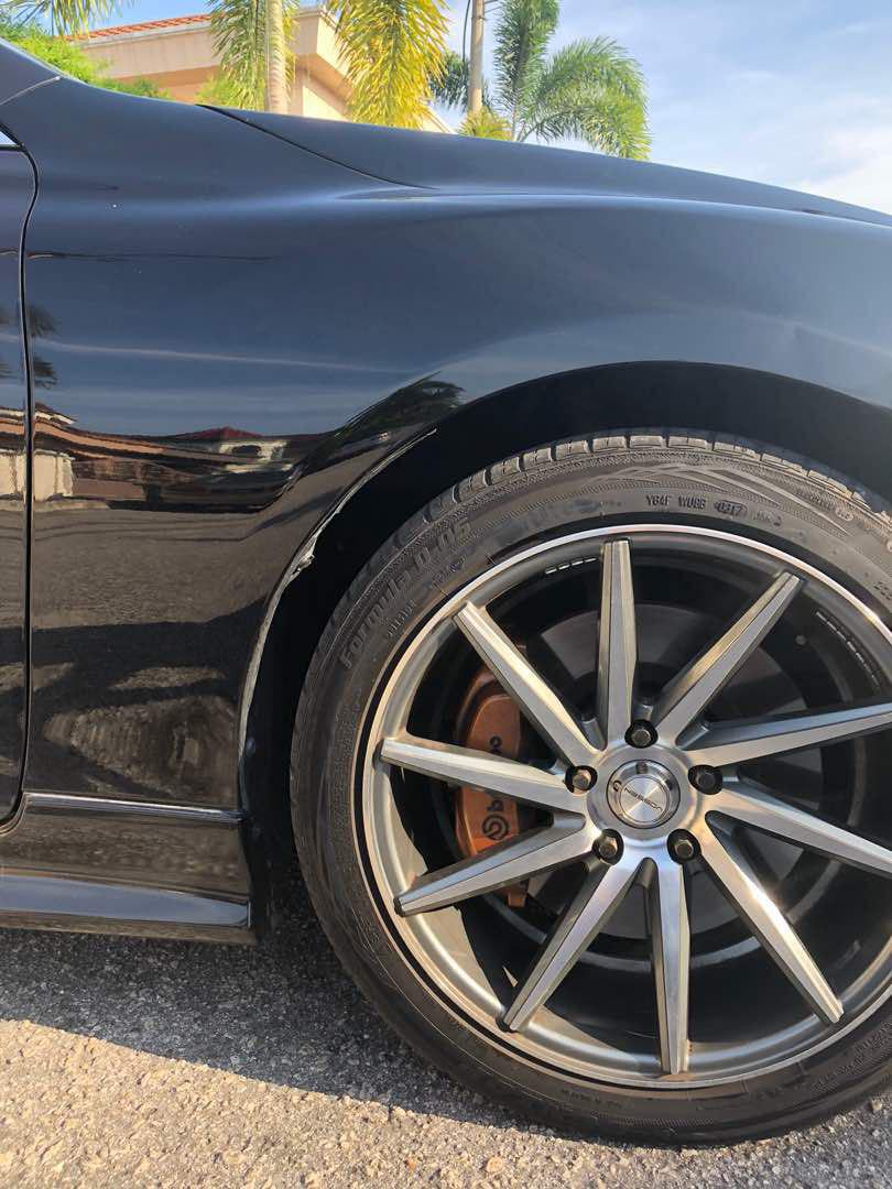

Mine is on 18x8 et45 at the front and 18x9 et40 at the rear, using 245/40/18 all around. Stock for Sports Package GRX120 is 18x8 et50 using 225/45/18 while for GRX130 is using 235/45/18.
Mine is Vossen CVT, not sure offset.
