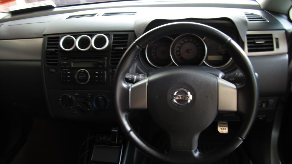

hi newbie Nissan may i know what car are u driving
i am driving a HR 16 Small modification done like you too:
i never change the exhaust set because was fully imported blast || Impul
same like you-adjustable lighten cam-pully
-air filter remain oem, just change to K&N.
-Hot Inazma VS
Im probably NA at the moment but now i am wishing to have ECU which i can gain few Horse and save few buck when i upgraded to Supercharger by still using the same ECU
many was recommended me like E-manage,Piggyback,Unichip,Shadow E-drive Throttle Controller..i am so confused which to choose
Please advice sifu !!
ok im driving the 98 nissan sentra b14. done all the useful mod on engine respond that I could. for your latio, pretty sure its a modern car. as alot variable modern car with dohc engine,there are plenty of power to rev until 7000rpm n then revcut. one of the way to unleash power is still the same I would tell, "remove revcut, increase rev to 8000rpm"
this wont "give" you extra horsepower, but indeed helps alot for 2nd and 3rd gear acceleration, more wider power band to use.
alas, i recommend emanage blue for it's affordablity, agility and alot mec is able to tune it with an affordable price.
but if you can spend like rm1600, then get a Power Sport air-fuel controller, they do wonder n give super fast engine respond!
