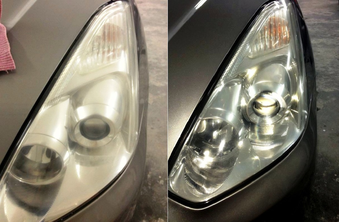

Hi Guys,
Any recommendation on how to DIY to protect your head lamps from turning yellowish over time?
Thank you.

Some accessory shops mentioned tinting but I don't they will last either. Looks like when Turn yellow, sand down and clear coat back....
