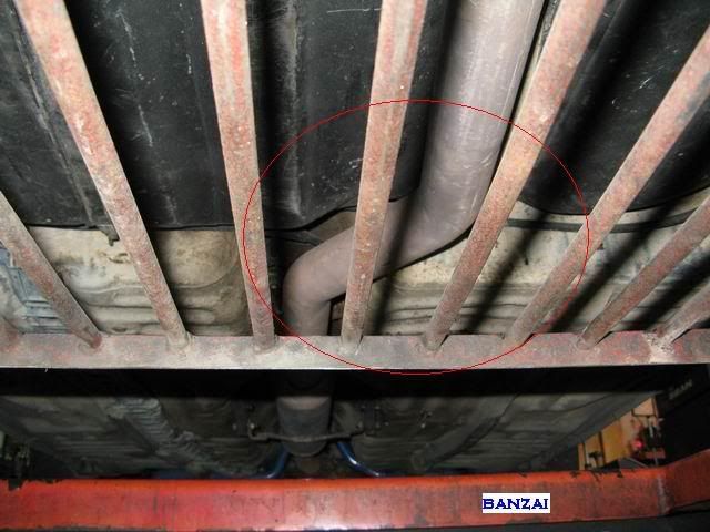

soly..asking to all ae92 sifu hear..if ae92 body wan to used apexi N1 full piping from ae101 body can or not direct PNP..or need to change the ae101 fuel tank as well..if after change the fuel tank..got another part need to change or juz pnp..

u definitely need to change the fuel tank to ae101 levin tank. if u do not change it, then u have to cut the piping and make it go lower as ae92 tank has different curve. changing the tank itself will not involve changing other parts.
i am using ae92 tank and apexi n1 pipe...i just do the pipe extension at front...the pipe really dekat with tangki,but i had already ensure no movement la there..
change to ae101 fuel tank is think is must... becuase ae101 tank got a some space for piping get thru.. haha

easier to explain..
tat's the ae101 tank groove that enable the apexi N1 piping curve nicely. if maintain ae92 tank, then you just have to solve this part.
you all really joker la...pic taken in kedai tayar, tat's why got tunnel with red metal protection....hahaha..

hahha. just joking. i believe thread starter already got answer to his question, as banzai sifoo and 7heaven sifoo already replied to him. so, if change to ae101 tank, he can use the n1. i thought cannot, as a friend of mine, ae92 two door, tried to use that, the foreman said cannot, but maybe he dont have the idea of changing ae92 tank with ae101 tank. so, i just highlighting the blue bar under banzai's car. in bahasa melaysia = cari benda2 tersirat.
