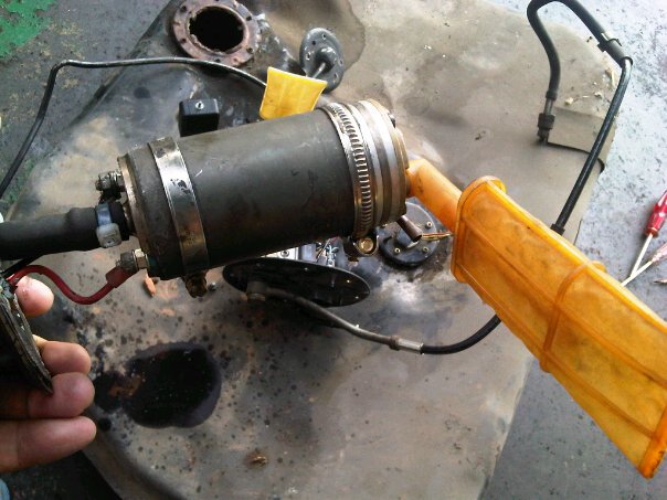

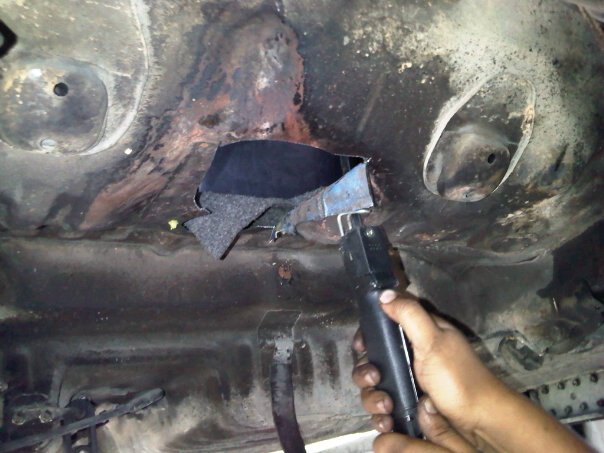

hi..sorry for late reply on this thread...here some picture taken yesterday....

Nicely done! May I know why cut a hole underneath the rear seat? Is it for clearance or to make easier access to the fuel pump?
What was the total cost and most importantly which workshop to do it?
Thanks!
i think he cut a hole on the bottom so that the top of the fuel tank can fit into LE underchassis??correct me if wrong..haha...i have seen an LE mod like that before...but using ae92 tank wiv rear seat chassis cut...
hi guys.. what was told by ae101rulez is true. acctually is not just to fit the tank only..i make big hole to easier me to access my fuel pump like what pcmoddingmy said...i will post to you all today pic from inside..after this planning to find a plate and close the hole from inside...
