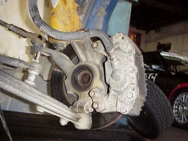

bro phr3ak, u did mention that u are using lantis 5lug knuckle..then why is ur car(shown in photo) 4 lug? or u are using standard knuckle?
besides the bracket, did u do anything else? like ...adding spacer or something?
is your bracket somethig like this?
yeap, my bracket looks sumthing like that, the location is correct. I used to use 5 lugs lantis, all 4's (normal calipers)... then i changed to 4 lugs wit FC calipers... simply coz, my spare tyres is 4 lugs... haha...
the 5 lugs can be modified to suit 4 lugs car...
but lazy to do that.........
as long as don't drive fast and keep safe braking distance, I think should be okie.....

I still got a set of front B8 knuckles and and calipers. Brake pad should be ceramic compound cos the disc that I'm using now, before skimming; the disc was eaten by the brake pad kau kau.......that's why I still haven't install the knuckles yet...
bro phr3ak, so let say i wanna upgrade all 4 to the FC Calipers and RB Rotors on my Tx3, what would be the cost like?? any hidden cost to expect?? my original set can trade in right??
all 4 to FC calipers? never heard of it done bfore...
front one, can la... rear FC calipers damn hard to find...
original BP brakes u can sell it...
about hidden cost i dont really know... ask ur foreman...
