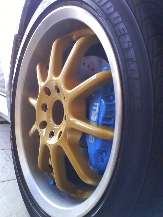

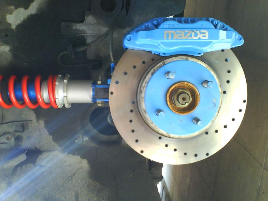

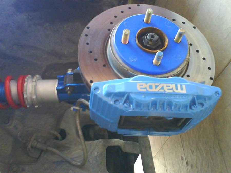

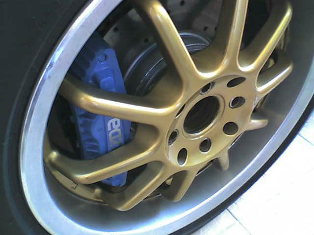

my mazda BF now fitted with Nissan Fairlady Z32 caliper n disc.
hv to do some on d bracket n few more stuff..
hope this pic wud help..

wow, thanks bro! beautifully done! plus u sprayed MAZDA on the calipers :adore:
is that a blue spacer u put in? so you are using wut dimension rims? 17"/7.5"? the rotor size?
