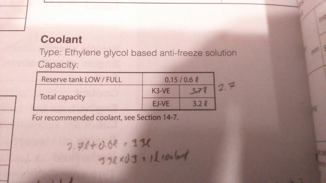

- I have doubt about the manual as someone around this zerotohundred forum point out the coolant capacity stated is wrong, it isjust 2.7L not the 5.7L stated in the book. I agree with it since i flush my coolant b4 and feel 5.7L is abit too much, impossible). DSC_0337.JPG
