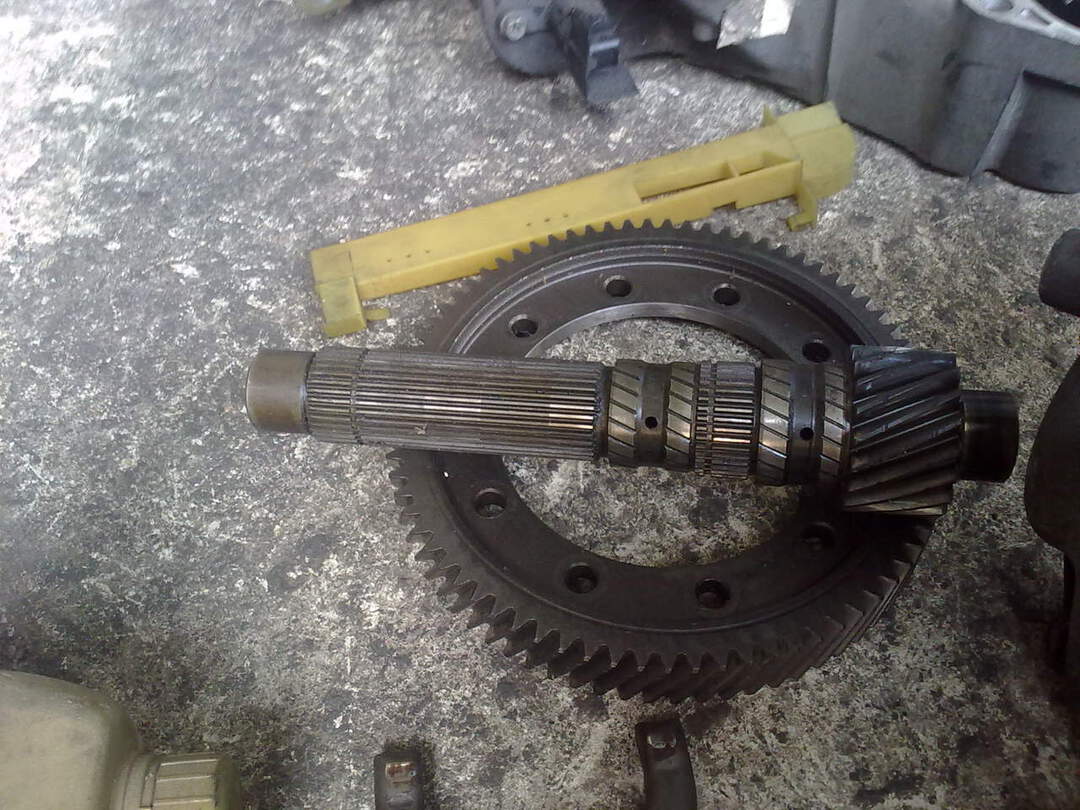

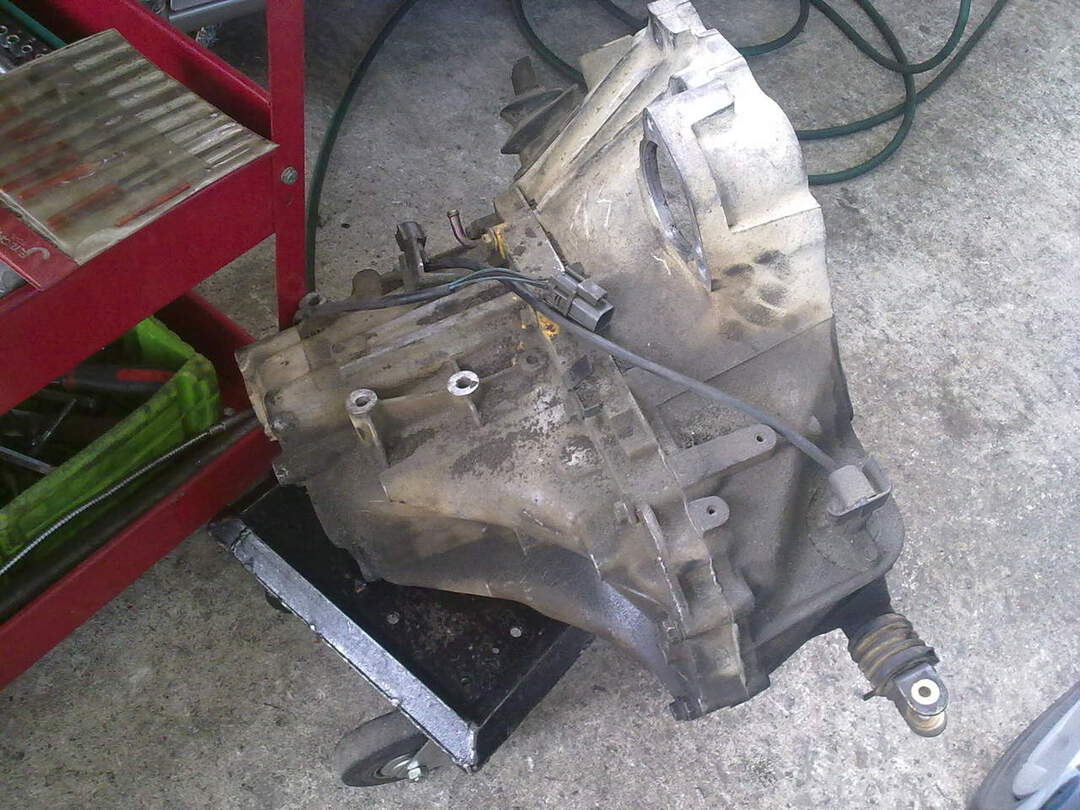

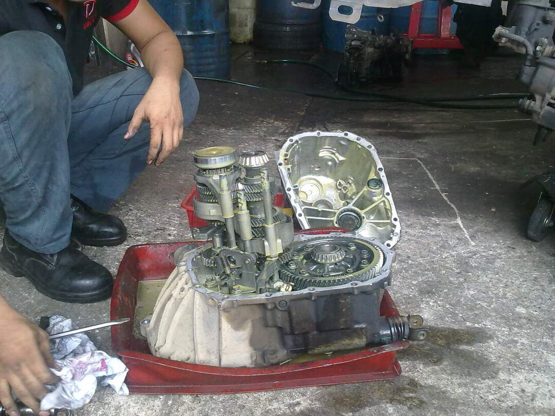

OK This is how our Manual Transmission look like (in and out)
wah
OK! This is how our A32 Manual Transmission look like (in and out)

4.) 5th gear I decide to use back the 0.795 ratio rather than 0.740 because when gear change from 4 to 5, the rpm drop more than 2000 pm and slow on rev up, so my new 5th gear is 3k rpm is around 122km/h and is it much more better.
5.) I also lighten the flywheel about 4kg.
