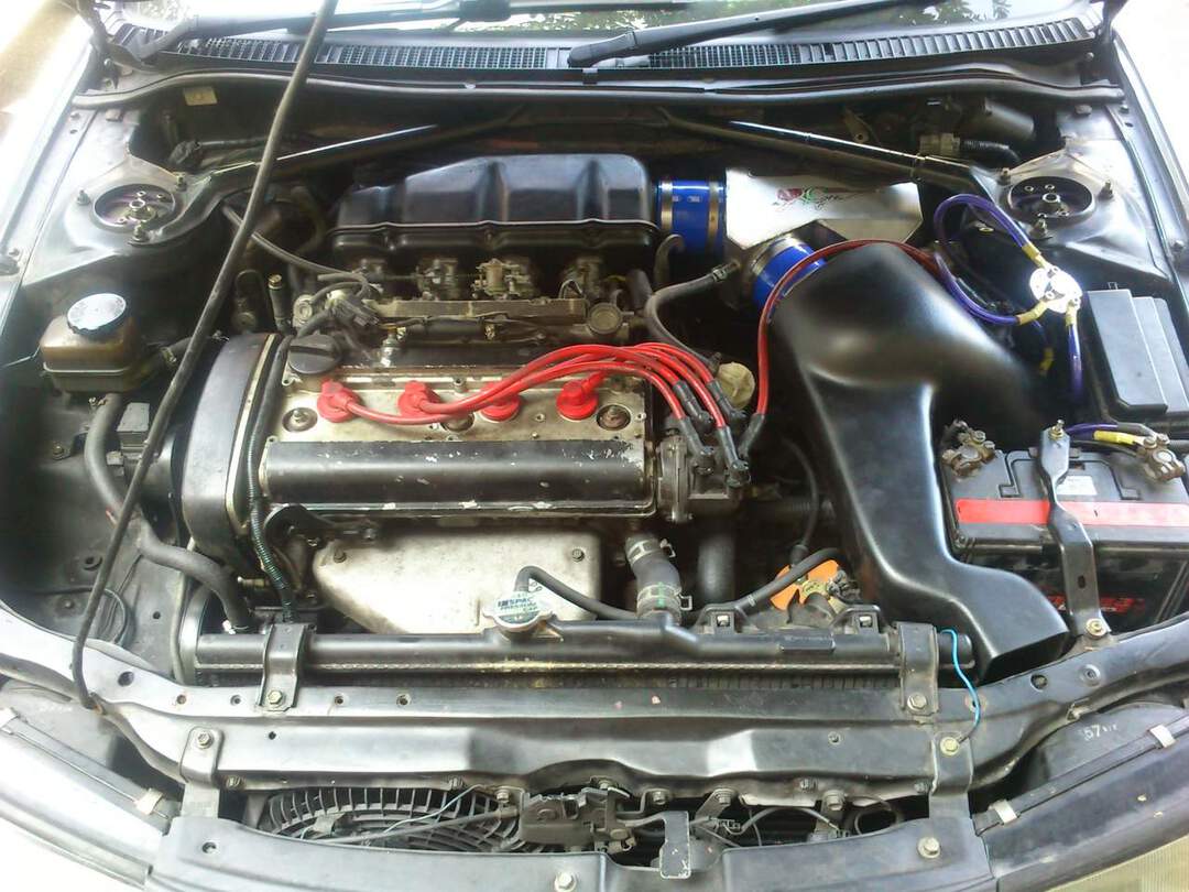

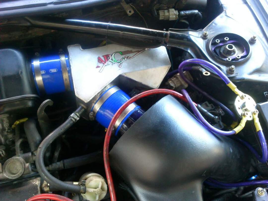

i've already install my arc box & toms air intake
it takes me more time to install it than expected..
i hv to relocate my FICD, Ground cable thingy & ignition coil..
those things still hanging there.. will sort it out today :biggrin:

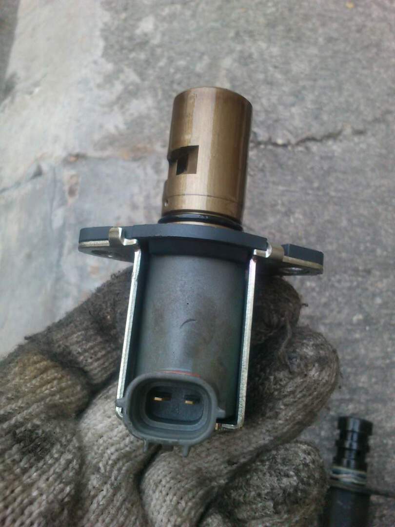

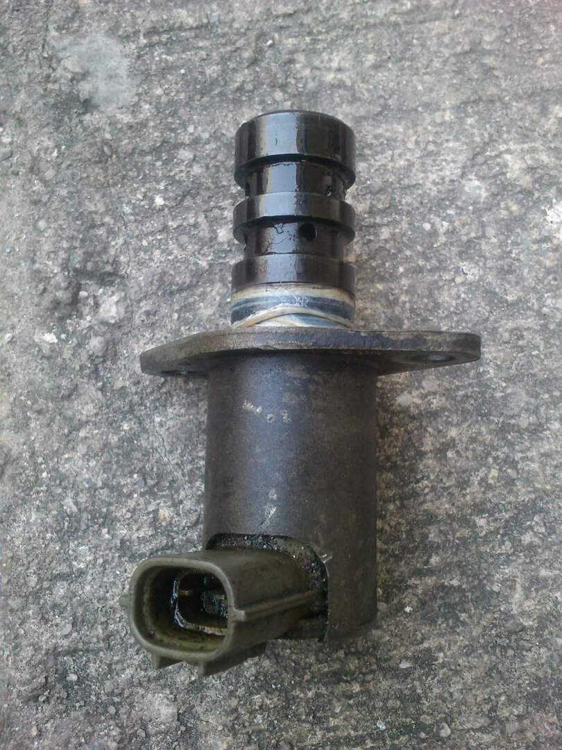

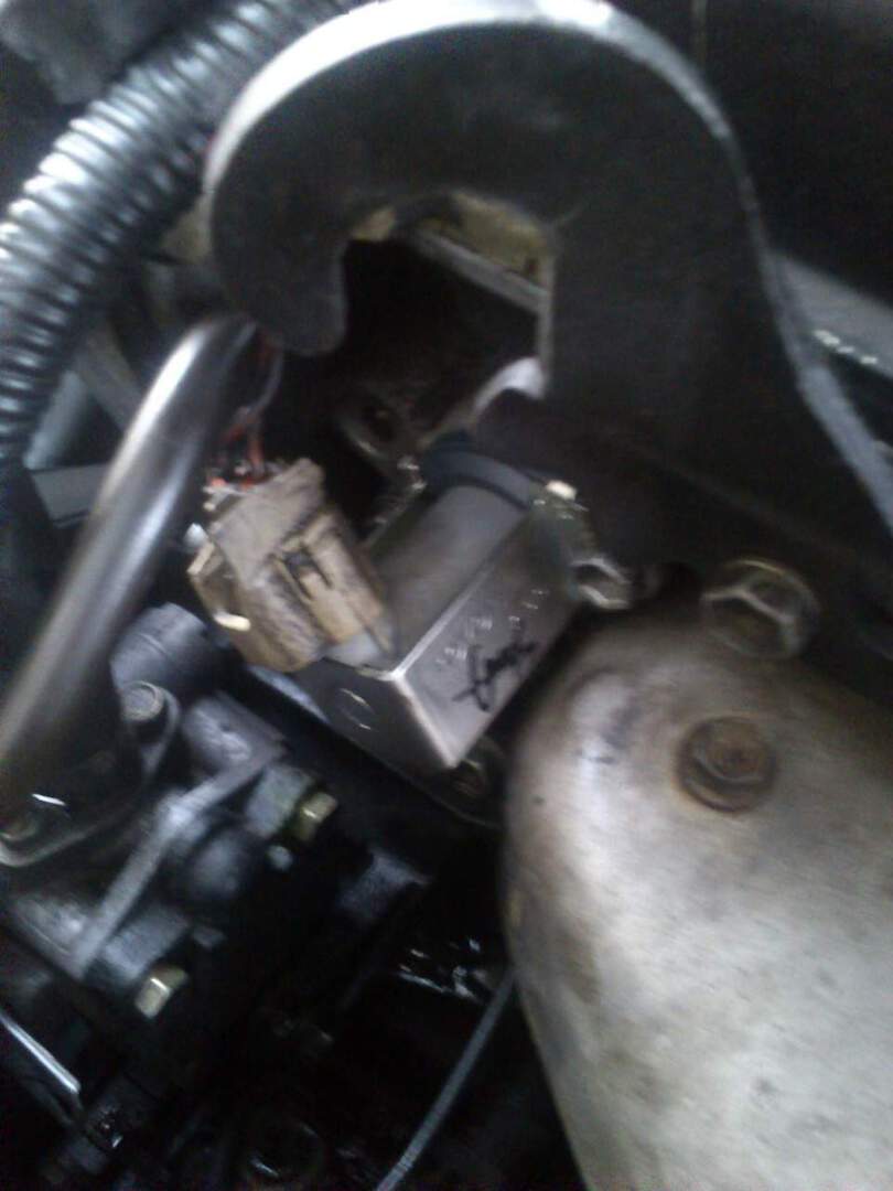

i've checked my vvt solenoid n it's not working.. will get a new 1 soon :biggrin:
hi dzul...your solenoid got leak or not...?? leakage also cause similar symptom...as the oil press will fluctuate/drop...for cheaper option try changing o ring first...
ps:// when mau TT..we can do it together gether... lol
yup.. solenoid leak like h*|| :biggrin:

p/s.. where to get the o-ring?

it's ok.. i'll try to change it myself.. but where to get d o-ring?

o-ring can get at any sparepart shop...last time i bought near your old place...rm 2-3 only...but better take out the solenoid first and bring it to the shop so that you can get the correct size...
if bt and st solenoid are the same...i still keep my old busted solenoid...no need to cabut yours dulu...can bring mine as a sample...cabut when have the oring ready...save time and energy... :idea:

I've already take it out n test it.. It's not functional.. Need to change
Shockingly d o-ring is missing :banghead:
Temporary put white tape on it.. Will find new solenoid tomorrow

There is a small O ring inside the SVT solenoid but need to cut open the shell to reach it.
If we can replace it and close back the shell then we can solve the leak problem.
