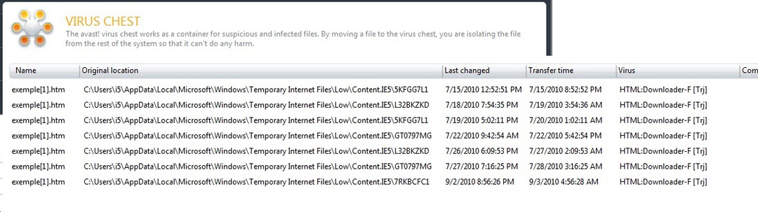

hi kian27
would you by any chance have the report with you?
this would help us detect the infected files better
Thanks!
attachment.php
this 1? if nt mayb other avast user can tell me where/how to find it, i will try my best. Those at july 1 is zth affect by malware period also. That time i thought was my pc problem so i just ignore it until other forumer file a report at here i just realize.
last time when here is affected by malware when i log to zth page then avast will warn me & something about java will pop up (i didn't read it just close the pop up). hope it helps.

hi Kian
thanks for the reply
do continue to update us if you find any future notices
There was in fact a suspicious JavaScript file earlier which we've fixed.
It's now 100% safe. Your anti-virus shouldn't show any more pop-ups
