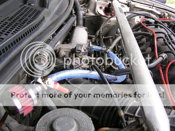

Then the vacuum hose pipe location should be same as mine, saga lmst. Just tap the pvc hose (vacuum hose) add a T-joint connect to microcompressor...
For microcompressor, use an air breather. Add a valve to control the opening..thats all...i think the pic shown in previous thread is very clear already... B)

bryan, the other things is i notice another hose coming out from the filter thingy there, where to put mine for a carbie.??? sigh..me darn blur liows :(
for ur case...u should find two hose connected to ur rocker cover...one is right side...connected to filter box...another is left side...almost under the filter box air duct...this is the one....

The "other hose" is the original hose connecting air intake and rocker cover...

do u know where is ur pcv hose? if yes then tab from there lor......
tab meaning connect 1 more hoseto the orig routelor....:)
yarr. easy. just get a t joint one end to engine, one end to ur ori pcv hose and the other end to the valve connecting to the air breather
then voila

This is the air breather...i don't think got any effect even you pull it off and leave it bare...but of course don't do that la...dirty air will go in B) ...last time my mech told me one...anyway, what is the cable tug on top of air breather for???
dat depend on wat car wan.... some car pull off de PCV hose let it bare... de engine is like wanto die off... but for some car.. de idle will go up higher...

for iswara...that one is not pcv hose...my pcv hose located at another side of rocker cover...that one i left it bare also no effect... but if left pcv hose bare...straight die... B)
