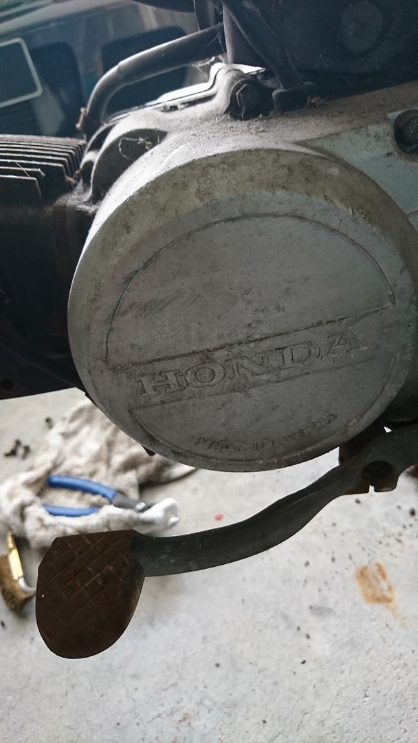

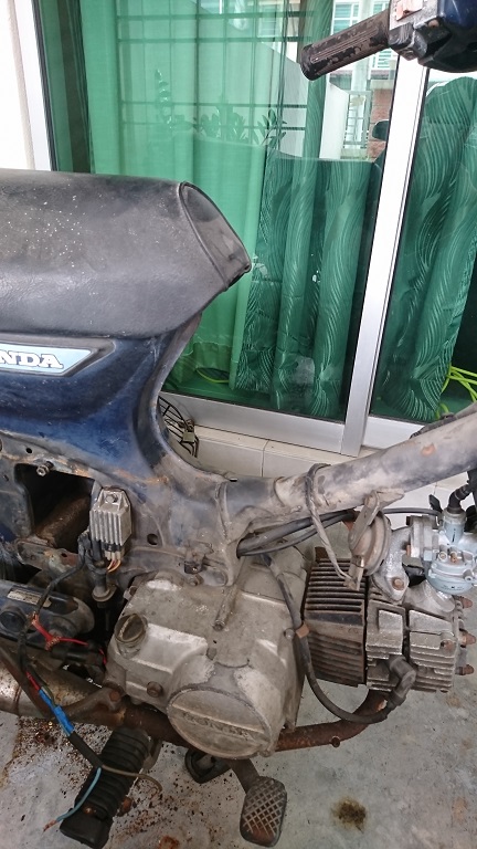

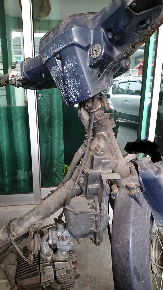

Here the condition when i open mudguard.

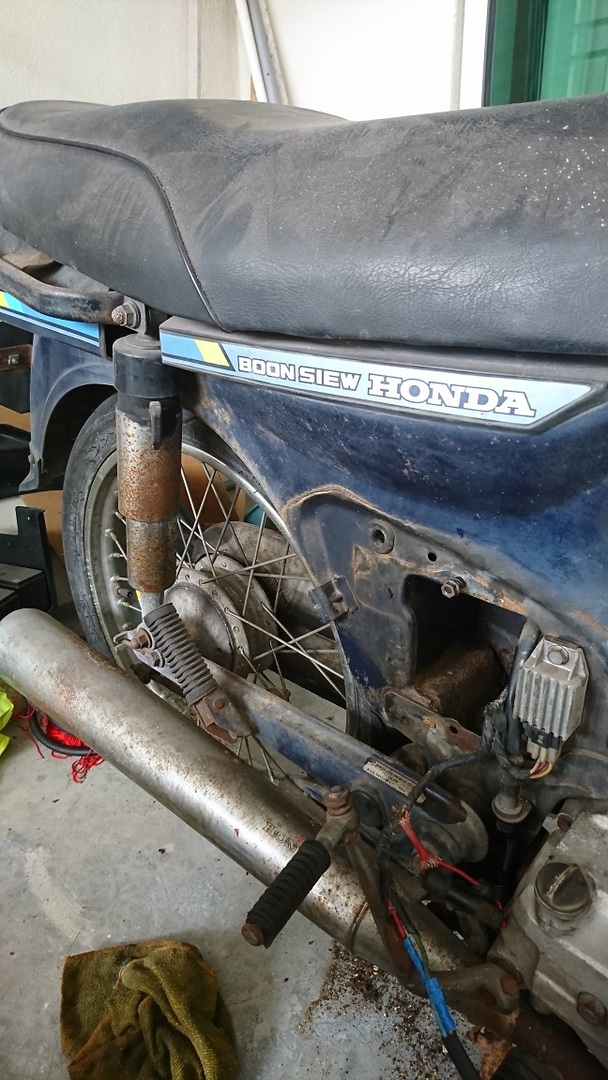

Battery compartment save on time. Scrap off rust , applied rust converter, spray high temp paint.

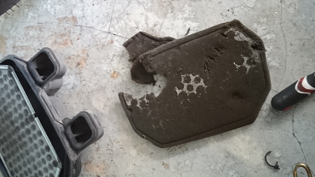

Air filter turn very brittle.

Alway reconnect the vapor hose from the bettery to dispersed out battery vapor outside the compartment. Its normal for the hose to be missin. u can use aquarium air hose.
So far from the picture its just surface dust so no worry. The sponge air filter is known to decayed and clogged the carb when no periodic maintenance is done. I just skit the sponge but kept the wire mesh.
