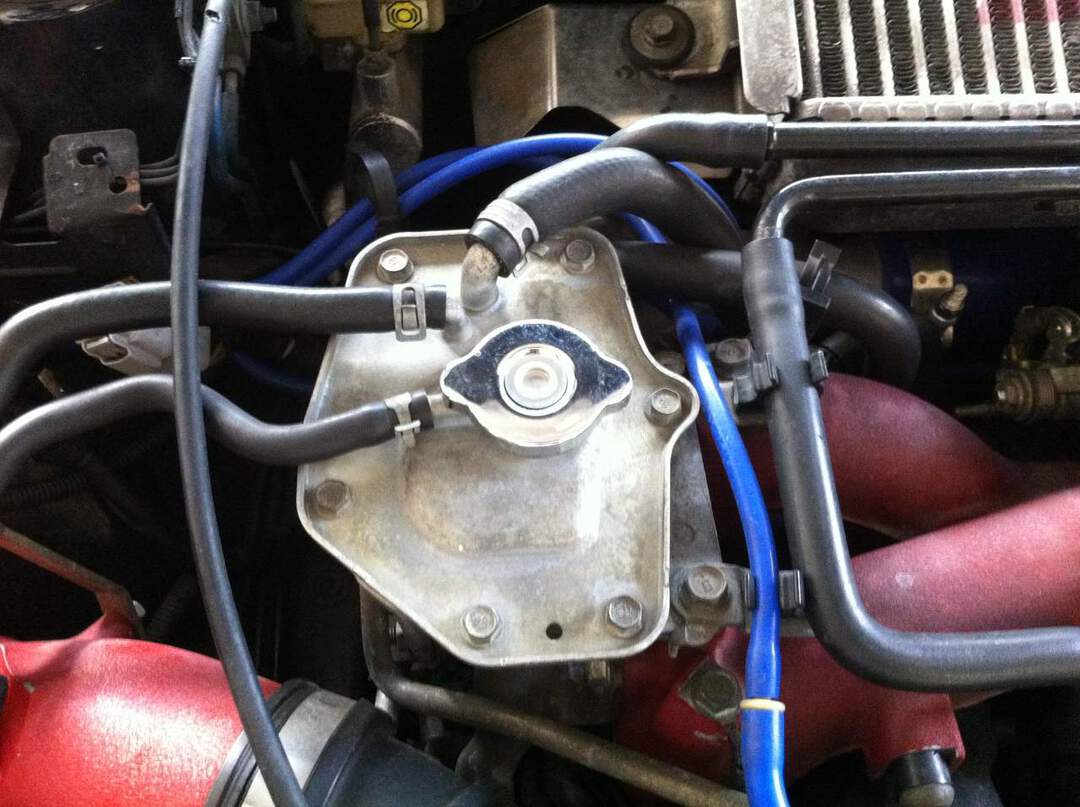

Just re-test again after engine cool down just now. same, without air-con water temp standard. with air-con on, water temp increast. And in reliaze some water burnt sound. May i know wat is this (Please refer attachment) TQ.

Bro, just make sure both radiator and turbo reservoir have full water inside. The picture you shown (reservoir) must also have water inside and make it full.
The plastic reservoir besides the radiator must be in Full Level, follow the markings.
I have the same dilemma last year when i bought my STI ver 8, forgot to add water in the turbo reservoir tank and make my radiator leak and overheated.
Ic bro. Yup, will take note. But then, everytime also have 2 check the water tank? Im facing overheat 1st time ytd, thats why 2day brought 2 AE check.
the "water burnt sound" as suggested by the TS may suggest water leaking fine line crack on the engine block. The leak can be very very little, esp. when the engine is on load, due to higher water pressure/volume being circulated..
When water dripped out, it will be vaporised upon hitting the hot metal parts. This might be the source of the ""water burnt sound""
