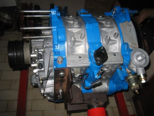

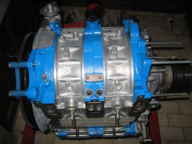

hey dev, ur blue paint is temp proof? haha looks like it, cos the bottle is abit different. when u open up, hows ur apex seal looking? must learn from you how to take out the parts mate
Hey eric,
Yup its hi-temp paint. I'm using Duplicolor paint which is good for approximately 205 degrees celcius. Lets see how it keeps up.
BlackSamurai said:
phat7, nice paint job.
how did u cover the parts you do not want to get the paint on? mind sharing?
Thanks Blacksamurai. I use off the shelf masking tape. it is tedious to cover specific parts but there is a method. hard for me to explain. perhaps when we meet i'll show you.

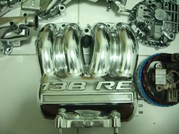

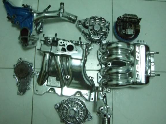

better not forget to thank my wife. here are somemore after using nverdull which retains polished surface. i used this in university to clean warches.
engine ready just need oilpan arghhhhh!!
nolah. i'm using cosmo upper intakes and lower manifold coz its bigger. Only setback is to port the fd iron housings to mate the manifolds perfectly. that process was also the scariest as if you "over port" can say bye bye to housings and have to get new ones.
