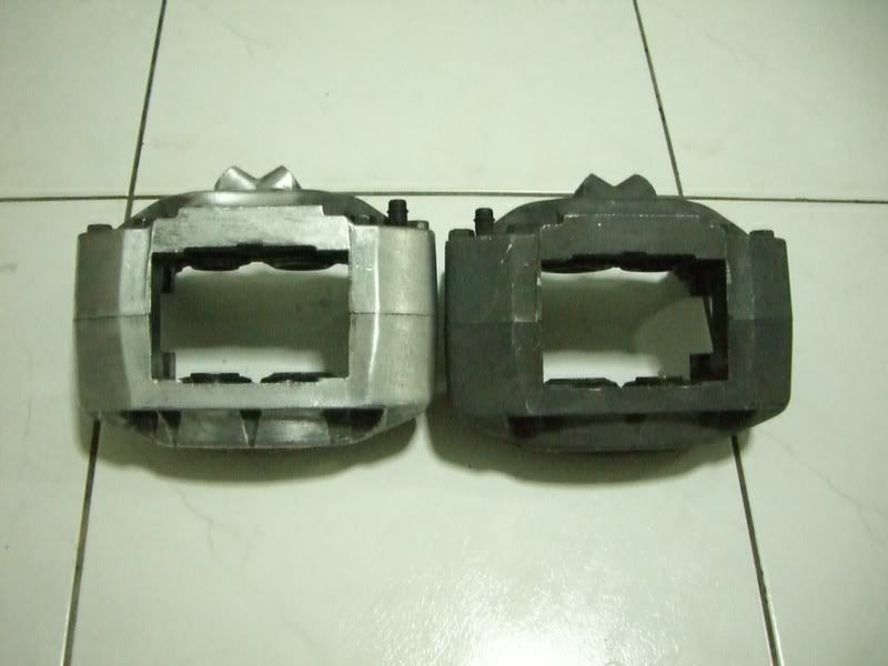

The finishing prior to painting should be like this-
http://i45.photobucket.com/albums/f73/fd3s7007/caliper002.jpg
Spot the difference-
http://i45.photobucket.com/albums/f73/fd3s7007/caliper053.jpg
Yup- SUMITOMO-NO MO :)
http://i45.photobucket.com/albums/f73/fd3s7007/caliper052.jpg

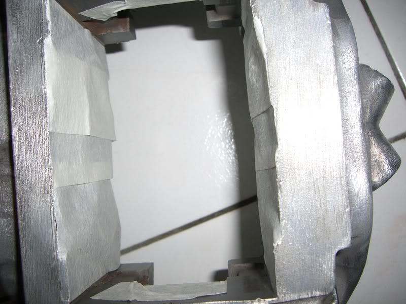

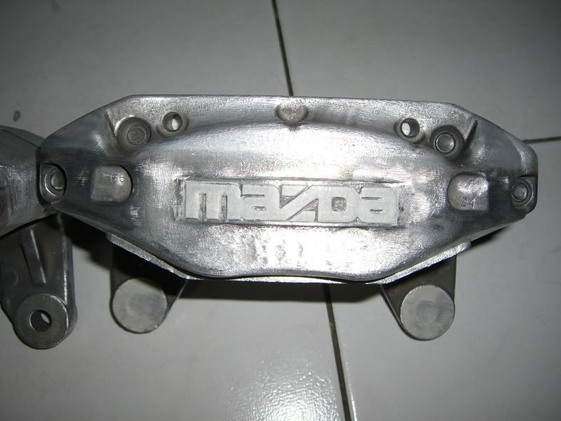

the overall scheme is going to be red but MAZDA will remain polished. To achieve this i had to grind down the metal and buff out to shine. Note- You want to make it as smooth as possible-
http://i45.photobucket.com/albums/f73/fd3s7007/caliper062.jpg
After of which you give the calipers a good cleaning prior to masking.
