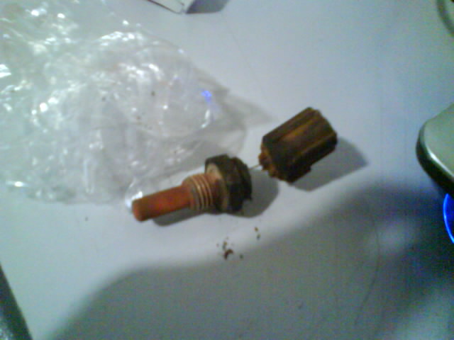

i'm going to my mech place in 1 hour time .. the ECT sensor reached already ... The ECU trouble code shows code4, which is something related to the ECT sensor .. hope it solves the problem :D and hopefully, my fuel mixture will drop back to lean mixture .. if not the increase in petrol prices gonna kill me very soon ..
reset the ecu by pulling the efi fuse, let it be for 5 minutes and switch the engine on. it will not run normally at first, but will gradually adapt wit the new changes. then, recheck the ECL and please inform us here sir. the best of luck sir

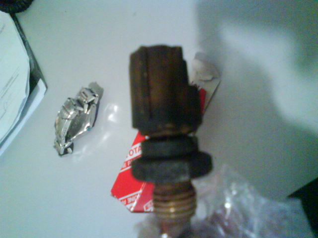

Woohoo ! Just came back from workshop .. DAMN ! The ECT sensor internals already broken and the internal wiring socket crack already !
Have a look at the broken ECT sensor .. Oh ya btw, if I dont reset the ECU, can it detect the changes by itself ? Now I can feel the difference on my car ... not sluggish anymore :D Previously, my engine like drowning when revving up to 3k rpm .. now feels so light !
Yes the ECU can detect the present of the ECT sensor by itself even though you didn't reset it. However, the error code will keep storing in its memory.
Enjoy your "new ride" :)
I reset my ecu already hehe .. then i bridge the TE1 and E1 again to check for error codes .. it blinks one time per interval .. which means its running in normal condition :D YAY !!!
good for u sir, yay indeed:driver:
Thanks extremeleo and others for being here all the time and giving some tips and advise :) Really appreciate it especially the ecu code checking method ... if you didnt tell me about it, i think the problem will still be there for a few more years :(
