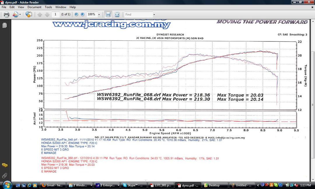

sorry a, using this thread for s2ki.com purpose.

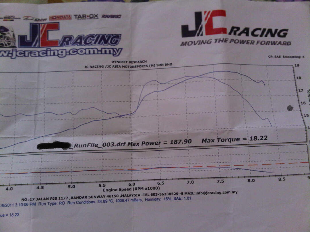

ITR DC5 facelift
Running 3rd gear
Stock Ecu, mode CAI, + catback exhaust RM01A. Anyway my car running @ low a/f at rpm 7k+ any idea guys...zz
