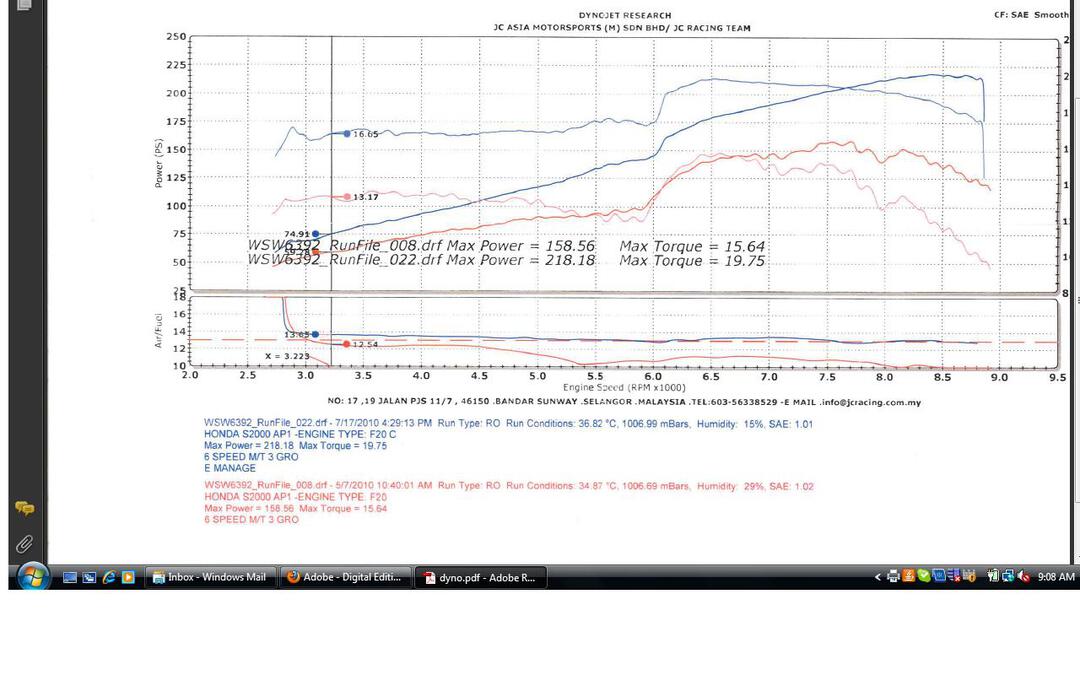

Test Engine: F20C Stock
Header: Stock
Intake: Stock
Exhaust: HKS Dual (pretty much useless) + Decat pipe
Gearbox/Tranny: S2000 AP1
ECU: E manage Blue
Dyno Test: Dyno Jet @ jcracing
power made: 218.18rwhp torque 19.75kg/m
ignore the old run file, lower reading has some problem.
