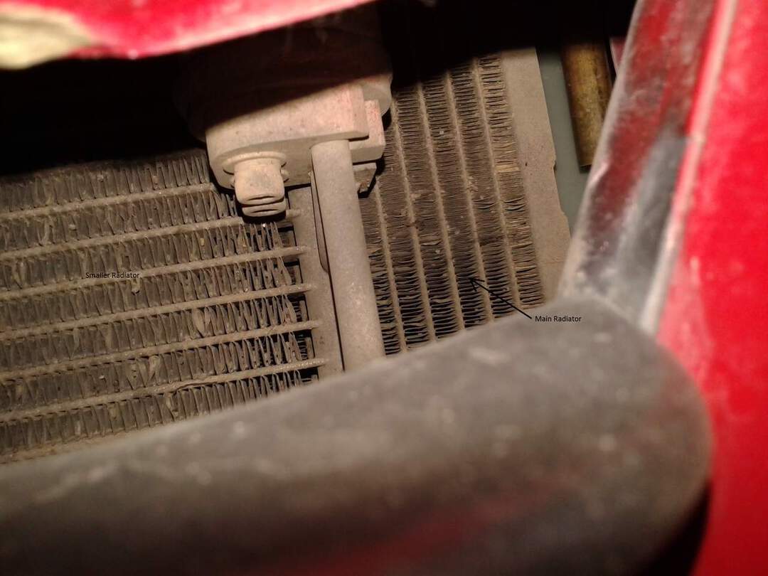

Hi Guys! I noticed that my Persona Auto has 2 Radiators, one is the normal water/coolant radiator and the other one is a smaller radiator fitted in front of the main radiator. I believe that this might be an ATF oil cooler. Can anyone kindly clarify on this matter?

Thanks for the reply! But I'm still curious about the smaller radiator fitted in front of the main radiator. What function does it carry?
No, not metal sticks. It is a radiator with many horizontal rows just like an ATF oil cooler but smaller than the water radiator. Please refer image attached.
its aircond condensor unit....
atf cooler is built in your water radiator (look at bottom of radiator got 2 small hose going into gearbox....

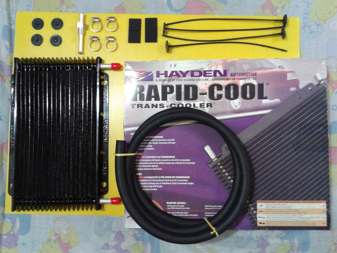

Yeah! I have inspected the 2 gearbox hoses and I intend to install an additional ATF cooler to reduce the ATF oil temperature further.
Get something to monitor the temp first. If its cold, gear changes are sluggish as well.
