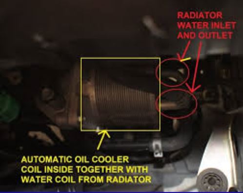

The picture above is basically the water/oil ATF cooler that comes stock with some of the older Nissan Sylphy / Teana cars. Basically the ATF flows in a U-shape within the canister and at the same time water flows outside to cool the ATF, water is courtesy of the coolant.

I'm contemplating installing an aftermarket ATF cooler but I have a few questions of concern.
1. The ATF oil flow is fast since the resistance is minimal. Prior to the canister is a paper filter so that already slows down the flow quite a lot. If I put either one of these aftermarket coolers, it will definitely slow down the flow of ATF. Will this be a problem in terms of gearbox performance?

2. The Nissan website said this thing is a CVT Warmer, not cooler. Which confuses me even more. So how the heck does this CVT work?
http://www.nissan-global.com/EN/TECHNOLOGY/OVERVIEW/cvtow.html
Help?
