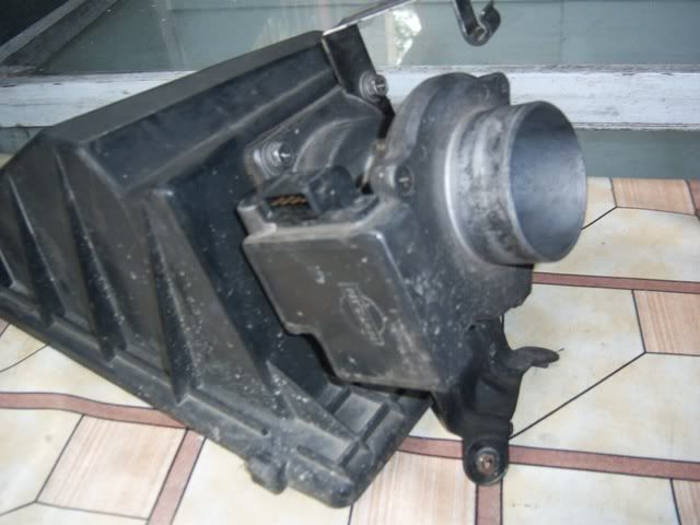

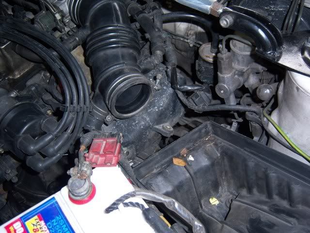

1st off remove the C-clip securing the MAF pigtail to the MAF assembly
remove the clips that hold the top part of the factory airbox to access the air filter and loosen the 10mm bolt securing the MAF to the airtube, dont forget there are also 2 more 10mm bolts securing the top half to the resonator box connected to the airtube
Here is the MAF assembly connected to the top half of the airbox
look through the hole of within the MAF assembly
you will notice within the small hole, will be the Hotwire Sensors for the MAF - these get dirty overtime - from a distance of about 6 inches away spray some carb cleaner, be careful not to be too close as not to damage the hotwire sensors - keep the carb cleaner tube at a distance when spraying but close enough just to remove dirt and grime on the hotwire sensors
WARNING: use some electrical tape and wrap around the straw of the CARB Cleaner to prevent the straw/tube from flying inside the intake manifold
Next Step - loosen the 10mm bolt that holds the clamp of the Airtube connecting it to the throttle body, open the throttle plate and spray some carb cleaner in there, let it soak

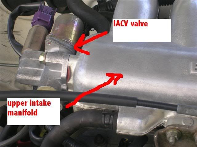

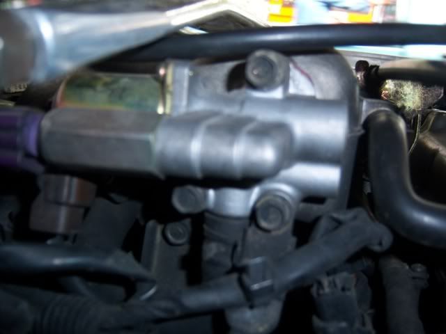

Next step in the cleaning process:

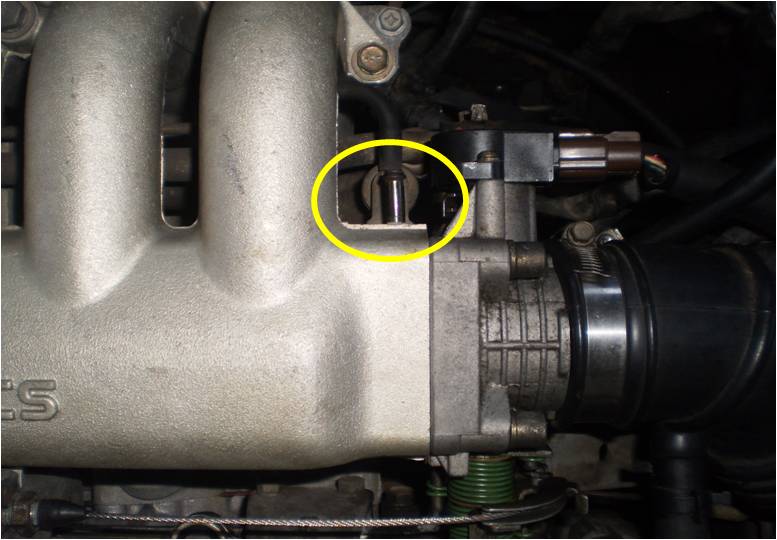

Loosen the IACV actuator plunger with an adjustable wrench, to loosen pull up (remember - Righty Tighty, Lefty Loosey) once loose, just leave it in there and do not remove - Yet
Removing may cause the plunger to fall off as well as the spring - they may get lost and you can easily screw yourself over)
Now loosen the 3 10mm bolts connecting the IACV assembly to the intake manifold then unsnap the electrical socket connectors from the IAC and AAC valve plus use a set of pliers to move down the clamp holding the rubber tube to the AAC valve then remove the assembly - be careful not to tear the gasket
when disassembling remember how the plungers and springs are oriented within the Actuators and assemblies and be careful as not to lose any springs or plungers
Be Meticulous and organized as not to lose anything, pay attention to Detail

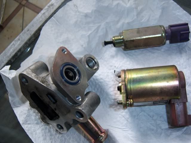

- Disconnect the AAC valve from the IACV assembly using a philips screwdriver
- twist out the IAC plunger assembly - see that littel plunger peeking through - remove that and be careful not to lose the springs.
both Round Assemblies have plungers and springs - remove and disassmble em and clean everything with carb cleaner
Caly has the updated AAC model with the sealed AAC unit with plunger and spring inside - just wipe the outer part out - dont worry about disassembling the AAC
spray carb cleaner on everything, clean the IACV assembly, plungers, springs and actuators with carb cleaner

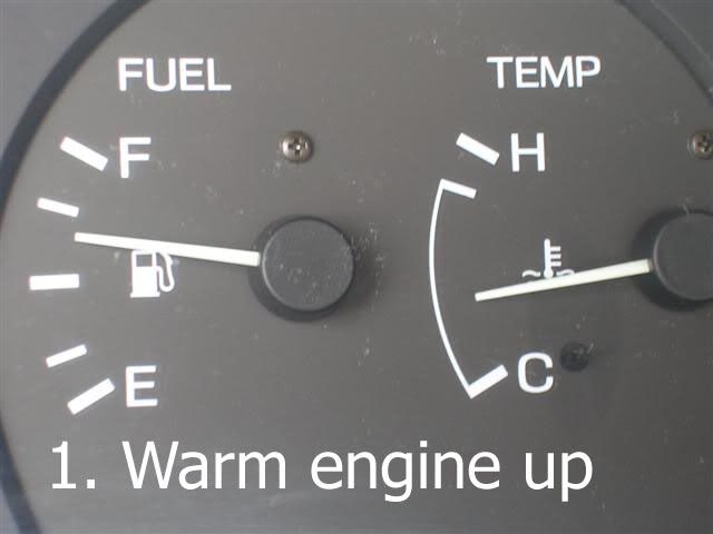

with engine running and in operating temp
1. Rev Engine 3 times Not Exceeding 4,000 RPM

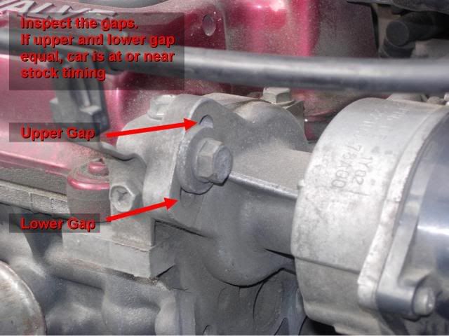

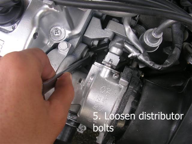

loosen your 12mm dist bolts
Center your Distributor Position - with everything in working order a centered Distributor should put you within the 10 Degree Timing mark - slightly tighten bolts

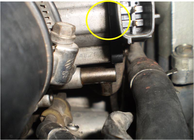

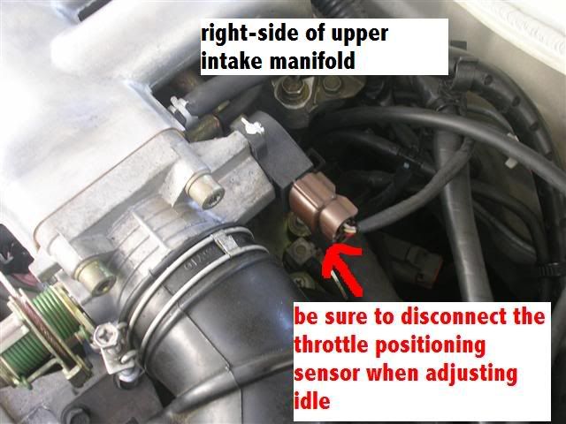

4. Pull/Disconnect TPS
5. Start engine

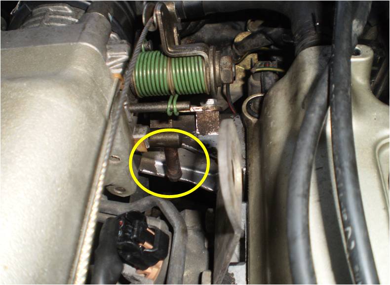

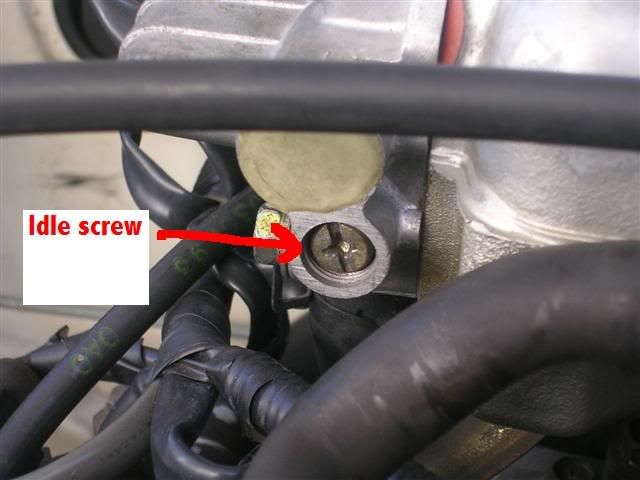

6. Adjust Base Idle Screw until you get 800RPM at idle (adjust idle only when Fan's are NOT ON
7. Once you have base idle Set, Check Timing and Make sure you get 10 Degrees of timing, loosen distributor bolts and adjust as necessary

10. here is what you should see and a guide to what the marks mean (the timing marks will illuminate when crank pulley is spinning and you have the timing light pointed at the perfect angle - you will need to adjust the way you point your timing light in order to see the marks), what you want is 10 degrees for stock timing, with the quality of fuel we have here in the Philippines i would go no more than 12 degrees advance, my personal preference is to stay at 10 Degrees
11. adjust distributor position to either advance or retard timing.
Forward to advance
downward to Retard

13. once you have adjusted Base idle and timing, turn off engine and reconnect your TPS.
