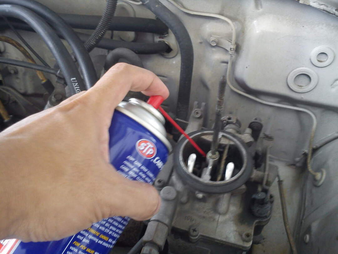

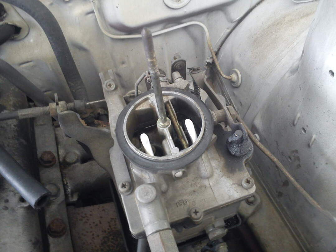

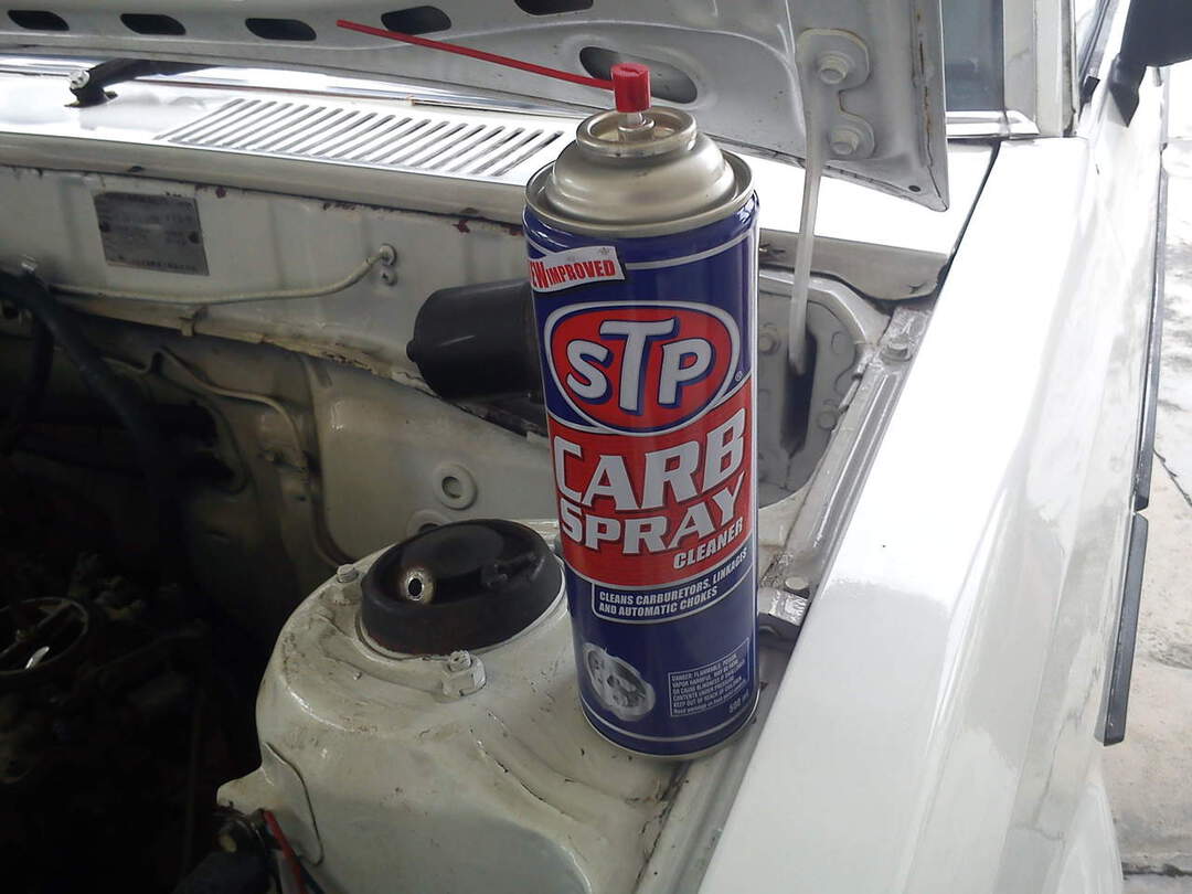

update..
done my 'cleaning'.. not as thoroughly as Izso did.. but ok la..
buy a can of STP Carb Cleaner.. and follow instruction on d can..
pictures enclosed..

Nice DIY.
Just a few notes. Make sure the adjustment screws are not changed, else will need to recalibrate the TB.
There should also be a small gap between the valve and body (the carbon that you clean off is blocking this).
regard the second and third picture from D7zul, may i know what is the 2 sharp rod which looks like the sharp edge of a drinking straw are for? Wonder what is it use for and where it leads to? Can i spray carb cleaner into it?
not sure what those rods are for.. there are similar rods further down the carb & it supply fuel to d engine..
i only spray at places that's with oil stain.. the rods are sweaky clean.. so, i don't bother to spray on it :biggrin:
