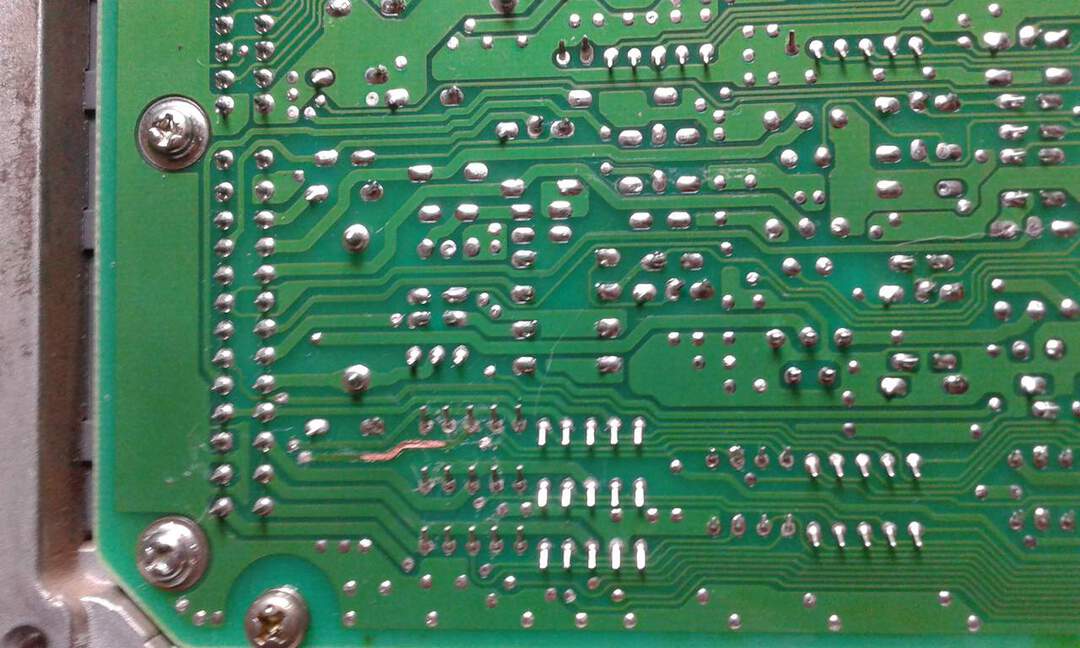

Hi i have cel 41 i do a mistake put a wideband 5volts on 1 volt ecu have fix?
ECU P28 M01 d16z6.

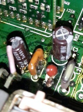

sir,
i have problem with my p08 ecu..
datalog show the tps sensor when full throttle only 6%, and when close throttle is -10%, it's make idle came rought, how i do to fix this case?
i try with my friend's ecu p28 my car idle stable, how must i check in the ecu board?
sorry for bad english

Masalah anda di kawasan ini kalau betkaitan
dengan TPS... semua capacitors wajib di tukar.

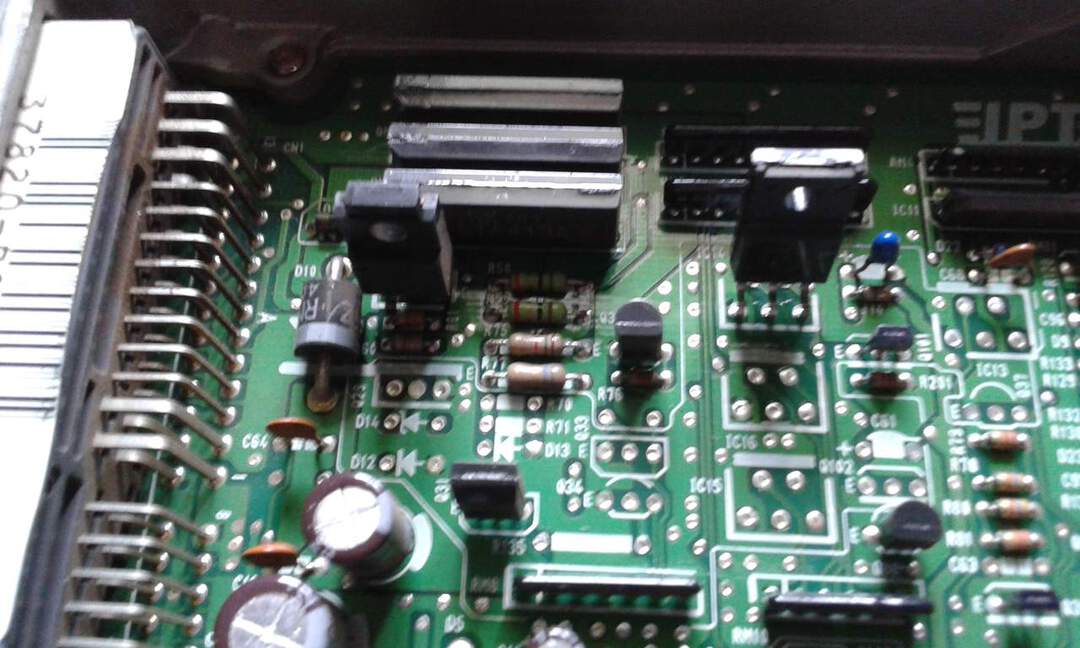

Hello again E-Tech.
I have 2 P08 ecu's that give a SOLID CEL (but primes fuel pump relay correctly on tester and in car)
SOLID CEL, NO CODE GIVEN.
On the moates engine sim BOTH ecu's pass with NO CODES. Run PERFECT on the tester.
Both ecu's are chipped and were working correctly for quite some time in cars.
Both have FLAWLESS ecu soldering and both ecus are in excellent visual condition. Both with the main CAP replaced. (wasn't leaking anyway)
ECU's give a SOLID CEL with J1 removed also.
Q: Where should I start? Is it perhaps IC19 data communications IC?
EDIT: I put J4 back, and unplugged the VTP sensor. I get a code 22 when I bridge service connector.
I remove the service check connector and the ecu keeps flashing 22 it doesn't go back to solid. Even when I key off key on it stays in code check mode with 22??
I have a feeling it might be the IC19. BOTH P08 have the same behaviour.
I dun hv and trust sim.
Let's talk about test in actual car.
Fuel pump prime but can the car start?
If yes, can rev pass 4500 rpm?
And post a good picture of ic19...
I haven't touched or changed IC19 yet.
If IC19 is damaged should I be able to datalog?
I'll try datalogging tonight before I change ic19
