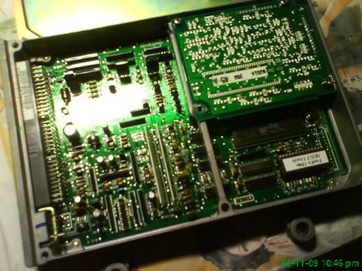

Bro, I have pr3 ecu with chip, need your advise
I think my chip still refer to the o2 sensor so i need a custom chip, my o2 sensor keep sending CEL & cant resolve it(even with standard ecu)
rpm cut at 8k, no speed cut
ignore o2 sensor. pls pm me the cost &
I will using VAFC as piggyback.
cheers

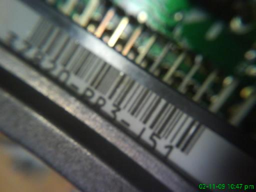

I have a long PR3 ecu and have chipped it, not problems....
Pls fix your o2 sensor. TQ
yeah its CEL 1, change it already, even do a bench test, voltmeter test, everything is fine, even discussed it at Hondatech, still no solution, change ecu also did not solve the problem.
anyway, so you have any chip for pr3 ? could you install the ZIF socket so that we could easily change the chip ?
ZIF Sockets
In that case, i would say it is the wires.
Need to trace it from da ecu to O2 sensor.
The p30/p08 chips seem to able to run on the PR3 that I have.

Here are some picture PR3 ecu...
