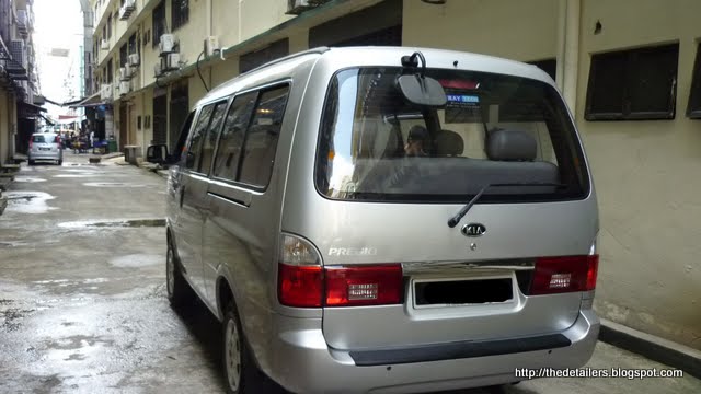

pic from a far

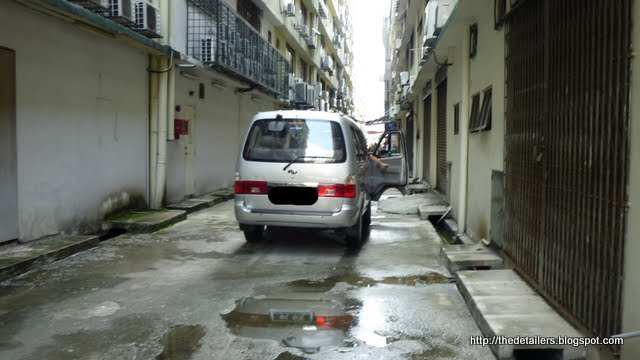

the famous pit stop lane

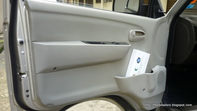

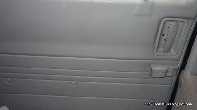

before

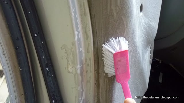

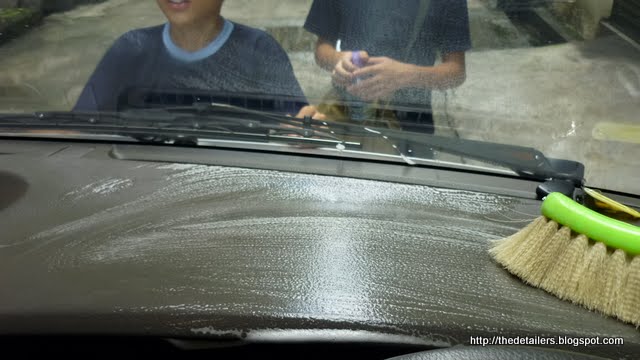

cleaning begins with OSREN MPC 10:1 dilutions

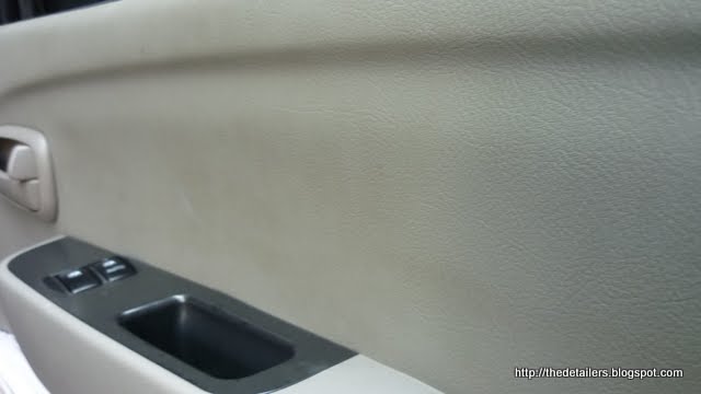

before

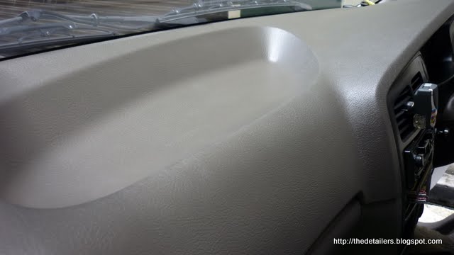

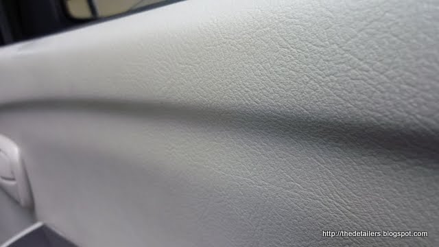

after

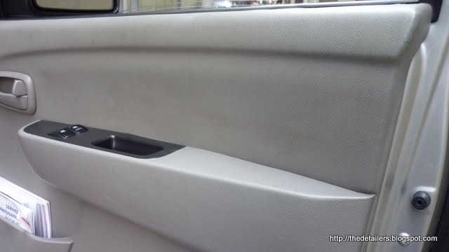

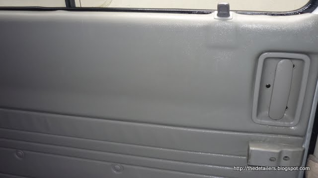

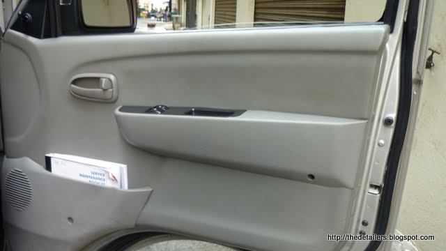

ta da the left side panel
cleaning
rinse away

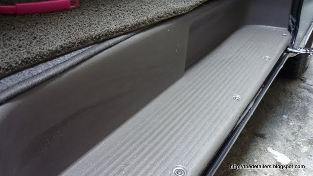

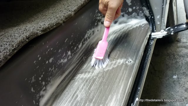

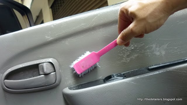

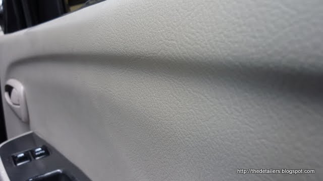

brushing the most abuse area...side steps...vinyl...OSREN MPC
ta da

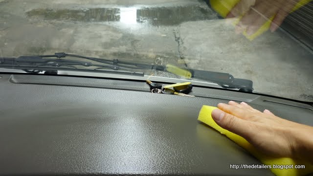

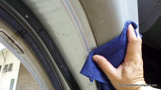

wiping away rinsing with damp cloths

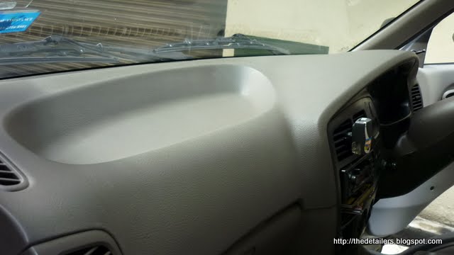

now a clean dash awaiting to apply dressing for protect..UV coated dash

my team members...thadeus on all vinyl parts

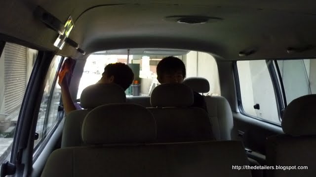

Phillip on all tyhe fabrics...seats..
Kok thye on all windows
