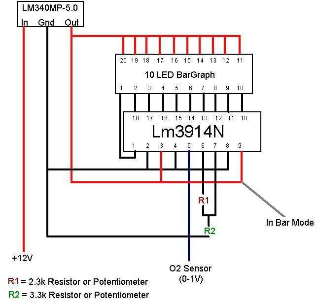

This is what I intend to build. Anyone can help me with the components?
Parts List
1. DOT/Bar Display Driver - National Semiconductor LM3914N
2. Voltage Regulator - National Semiconductor LM340MP-5.010
3. 18 Pin socket
4. 20 Pin socket
5. Segment LED BarGraph (never seen this here. Can replace with a row of LED's but a BarGraph looks way nicer and more professional.
6. Multi Colored LED (GGGYYYYRRR)
7. Resistors (2.3k and 3.3k)
8. Mini Circuit Board
9. Misc Wires - probably lying around the garage / house.
Optional Parts:
2x 4.7k Ohm Potentiometer
Data Sheets

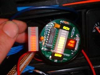

And this is what it is supposed to look like when complete. The unit on the left is the home-made unit, and the unit on the right is a commercial unit.
