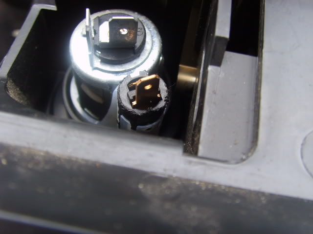

so basically ive bought these neons that have a switch, and they have a connection that has a white box on the end, it has TWO wires going in to this box, and i make it clear that this box will not plug anywhere into a car.
i understand that my very first step is to cut the box off and trim the wires back so i have two nice wires to go into my cigerette lighter (or am i wrong in thinkin this, do they attach to the wires that go into the cigeratte lighter?)?
i have the back of the cigerette lighter exposed and i have easy access to the wires that come out of it
however, ive tried looking up on the internet for help but from this point on im very confused as to 1) how i am meant to attach the wires to the cigerette lighter and/OR its wires and 2) what the hell is all this business about the ground wire that ive been reading on the internet
the cigerette lighter has three wires coming out of it, two of these wires are taped together, probably to indicate that there positive or negative or some shit lol
i would be amazed if someone could get me to do this, but im so confused as to what im meant to do with the wires exactly :(

back of the cigerette lighter:
TO EACH PRONG THERE IS ONE WIRE, THREE WIRES IN TOTAL

back of your cigarette lighter has 2 connection... positive and negative...
from the photo u provided above, the neon u gonna install has 2 wire to connect... red and black...
so i assume red is positive and black is negative... its pretty simple direct connection...
yes u can tap 12v DC source from cigarette lighter....
so the third little pin to the top of the cigerette lighter i just ignore? and keep it how it is?
and so do i wire the wires from the neon kit to the back of the cigerette lighter WHILST the old wires are stil attatched?
cheers mate
the 2 pin from the main cigarette lighter should be the positive and negative terminal... the smaller looking tower is for illumination (LED) of the cigarette lighter... can ignore that....
yeap... u can just tap the wires directly to the cigarette lighter without removing the old wires... hence, u will still be able to use your cigarette lighter...
