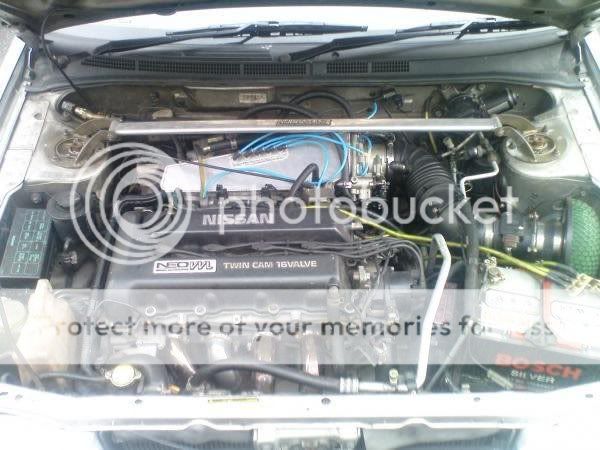

example of a custom intake manifold
pic is borrowed, owned by nchun1 (monster sr20ve):adore:

nonono, is not mine, is my friend nchun1. i think he is a zth member here too. i was asking is there also anyone using this kind of setup. normally this custom manifold gives about 10% extra engine respond n some extra horses.....
