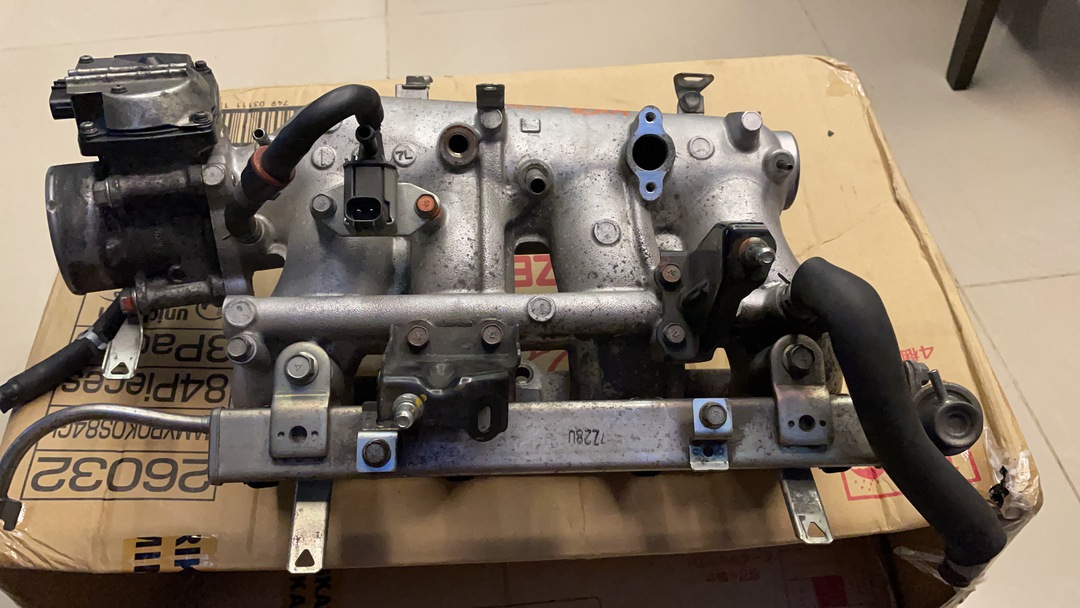

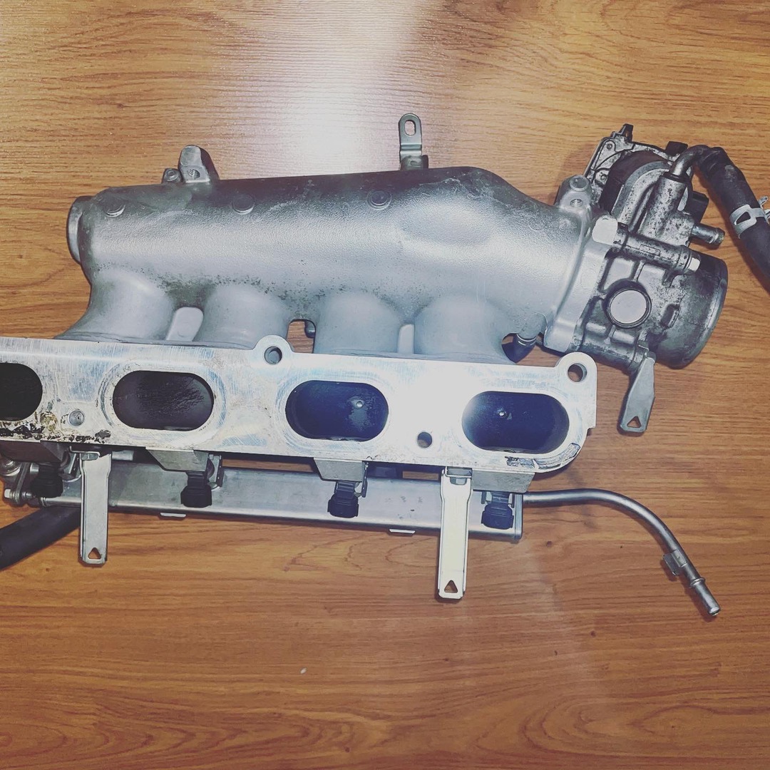

Part 1: Lancer Evo X intake manifold, Throttle Body and Fuel Injectors. This is a must as the stock plastic 4B11 intake manifold will crack over time when running with boost.
View attachment 581166View attachment 581167

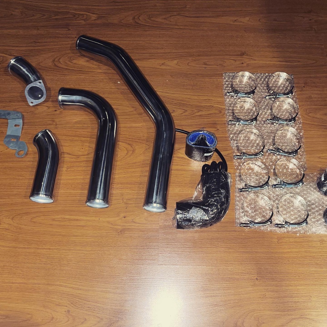

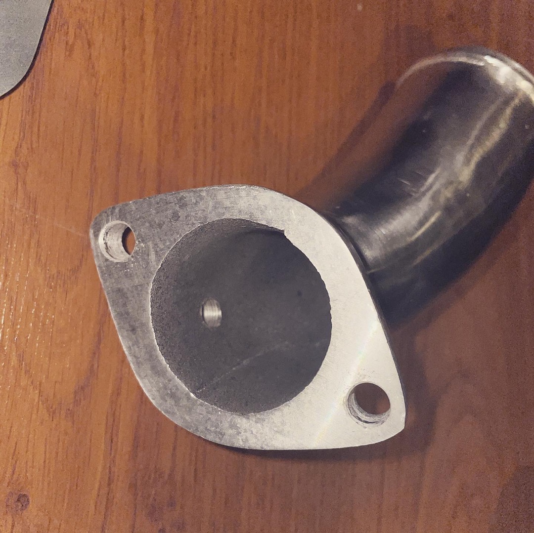

Part 2: Intercooler Piping - I want to save some time and customize cost on these pipings, so i bought a ready made 2.5" HICP, i still need to customize the air filter piping and LICP to join up the intercooler and throttle body. I did not manage to take a shot on the intercooler but its EVO X size with 2.5" inlet (Stock Evo X is slightly bigger like 2.85")
View attachment 581169View attachment 581168

Why not just get the stock Evo X intercooler kit?
actually should not be such a big dif, ic size has a much smaller effect on lag than one might imagine, unless its some obscenely massive item

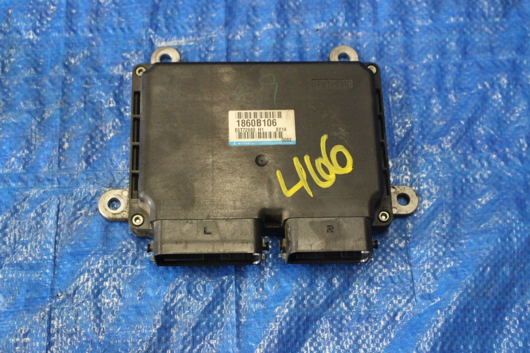

Part 2.1 ECU < The most important part for any EFI engines. PERIOD !
Evo X or Lancer Ralliart ECU. Forget about piggyback ECU, they won't stop giving you the dread CEL eventhough your car has no issue at all. The Lancer's cluster CAN just dislike any piggyback system that does not speak ETACS to it, so it will constantly giving you the CEL and sometimes messes up the engine's idling. Part number as per attached picture, my particular model is from Lancer Ralliart, 1860B106 is the part number. To use this ECU, you need to get OEM 3 Bar MAP Sensor (hassle free) and IAT Sensor. Both of these sensors are used on the intake manifold. There are 3 wires required to tap into the original stock ECU harness.

wait. how are you managing the ecu? Just reflash? Is this a evo X ECU?
