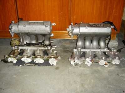

bro what damn is using gsr inlet manifold while deacon is using mivec 1..so any guys out there who have pic of both the manifolds to show all of us here wat's the actual diff between this 2 stuffs? any1 willing to contribute to this thread? ^^
Umm take a look at a 4G93P manifold it's the same as the Mivec manifold but the inside is different lah

eh if can get mivec inlet manifold as well lar..hehe.. >. oh oh oso measure the diff and state it on the pic thx ya koko

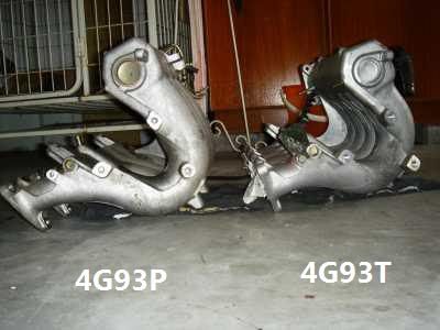

sorry for the delay, internet was down last night...but anyway, here it is.
from the pics, you can clearly see the different runner lengths and also the additional EGR runner and valve on the 4G93P intake manifold.
pls note that if you do purchase the 93T manifold, make sure you get the bracket that sits between the underside of the intake manifold and the engine block because your original one won't fit unless you machine spacers to fill in the gap in between, almost an inch between it.
