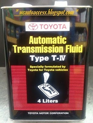

Hi Sifu's,
Got a quick question on the ATF for my V6... I've been using the Penzoil Semi Syn ATF for my car but i think it's not really suitable for my GB. Wanna try the Toyota Type 4 ATF as advised by our sifu's here... Can i know how the ATF looks like? Is it the one in the pic below? Please advise... Thanks siifu's....

what ATF does the V6 owner's manual states to use?
the owner's manual refers to SPIII.

I think many people use Toyota Type 4 ATF in Perdana V6, but why?
I always stick to recommended ATF i.e. SPIII, either ori Proton SPIII or Qiaqueen SPIII.

Toyota states that T-IV is only suitable for cars that requires T-II or T-IV and nothing else. Even Type T and Dexron III cannot use T-IV. Why would you want to pour it in your Mitsubishi gearbox is beyond me. Just use what the manufacturer specified, not what the mechanic bawah pokok says unless he used to be the Chief Engineer of Mitsubishi.
Yup it is not about what brand is good for your auto GB...it is about what type of oil grade that u should use...same concept with engine oil like 10/30, 10/40, 15/40 or 20/50...it is better for u to use what type of oil recomended by manufacturer and not by what brand suggested by people...
