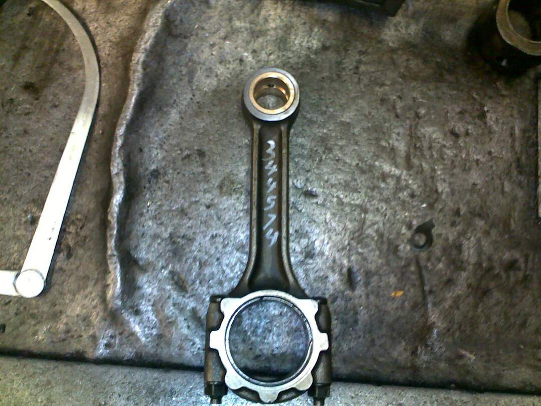

its on 4G63 block. i was told its been done before and its a straight fit... any suggestion on how to get it done. uploaded is the 4d68 rod with the modification to fit the vg30piston.
and the 2nd picture show when fitted the piston coming out of the block

No way... ur piston aldy told u the answer..
solution is either change ur crank to 94mm,
or change the piston to after mkt stroker piston..
Personally i suggest after mkt stroker forged piston..
Btw, ur 63 block is earlier batch(1,2,3) or newer batch(4-9)?
