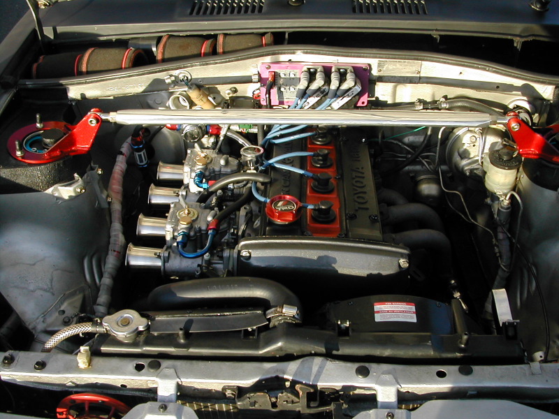

The hole in the trumpet? OHh! I think the previous owner used it for PCV.
Length tuned?!?! LOL!!! Look careful at the picture and the answer is there LOL!!!
HAhahaha.... I dont think anyone can know if this trumpets are tuned length by looking at the picture, neither do I !
If I were to ask if the trumpets' length are of equal length, then YES I CAN SEE FROM THE PICTURE.... funny me.
I was referring if the length of the trumpets were actually tuned for maybe , low end rpm? Mid? or even HIGH? You should know that difference in length of the trumpet does makes different.

here's 6 trumpet

edgar_raphael said:
but where is there a hole in one of the trumpet?
are they tuned length?
The hole is to install a air temperature sensor.
All pipes have it's own resonance frequency. The correct question is our case is not wheater they are tuned length or not, instead what are their frequency.
