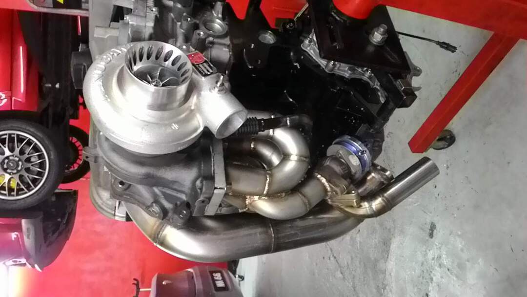

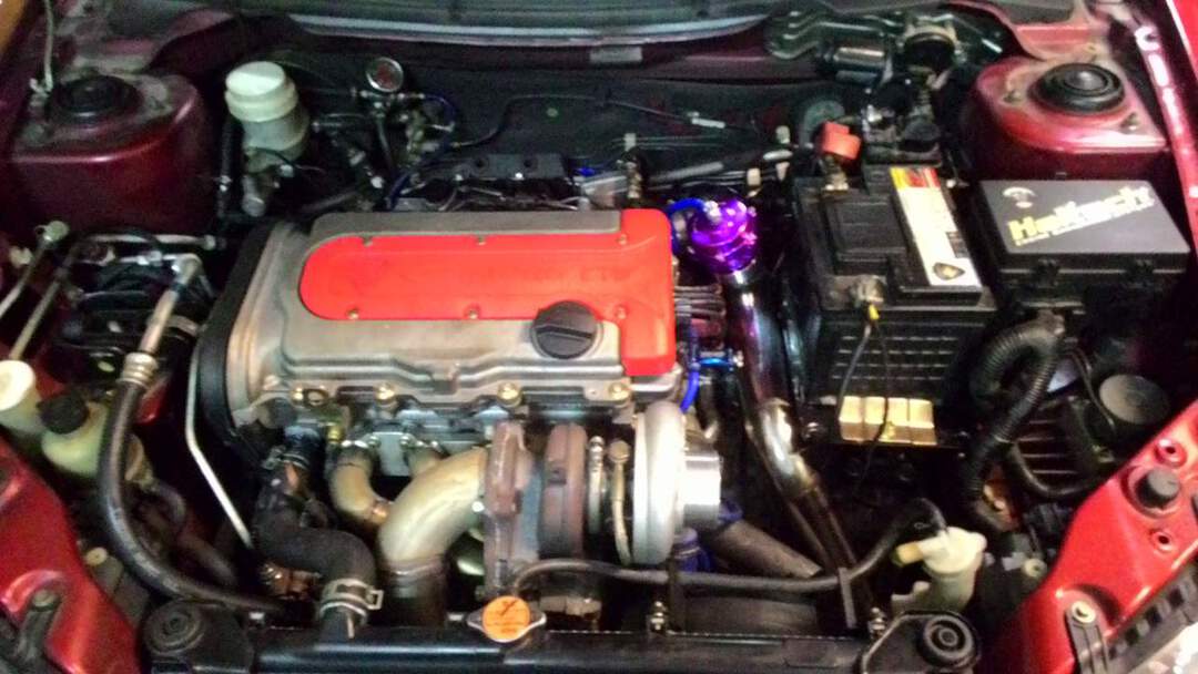

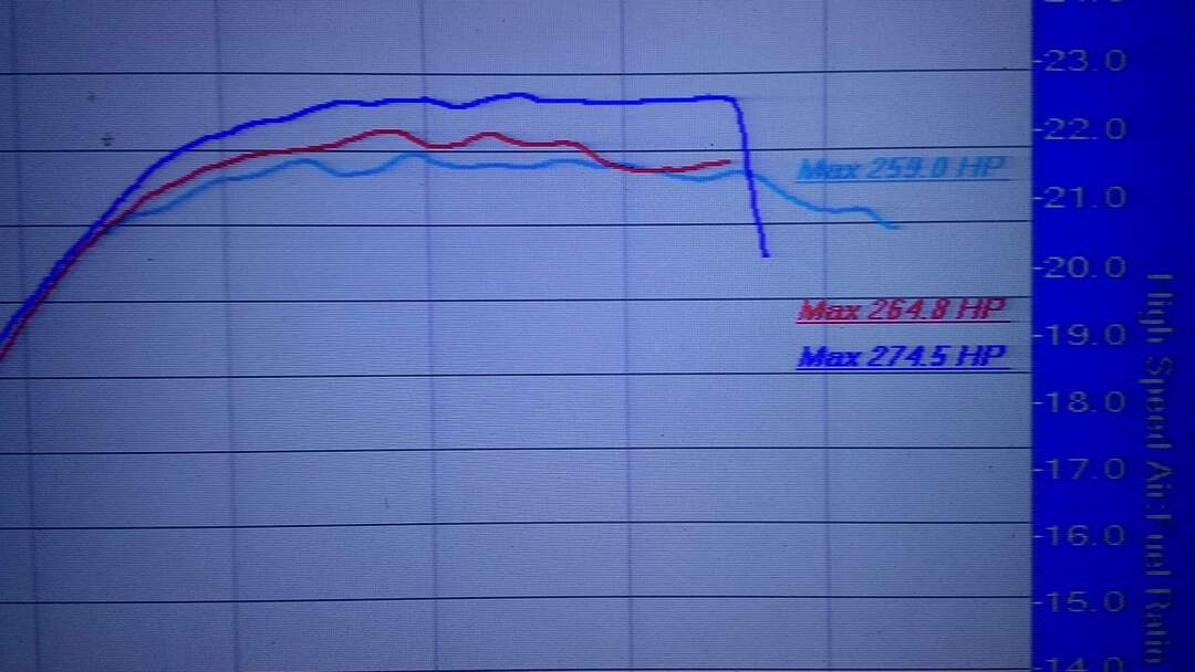

Campro turbo already easy can make 250hp to 300hp can reffer z1racing facebook, they alot make extream modification for campro engine.. thier new project campro turbo only 0.8bar already get 260hp, no need using stroker 1.8 just pure 1.6 stroker can refer f.b z1racing
Thats the thing. When campro needs to be forced inducted, the crank has to be changed, it super fragile. maybe ts upgrade as well. lol
i know campro internal are all so weak.. if change to forged internal, the whole engine is more reliable.. i even heard from frens in proton servis, one time overheat need to change new head. then even the piston can shrink so piston has to go as well.. that just happen to my brother's gen2. luckily can skim abit and use thicker head gasket.
